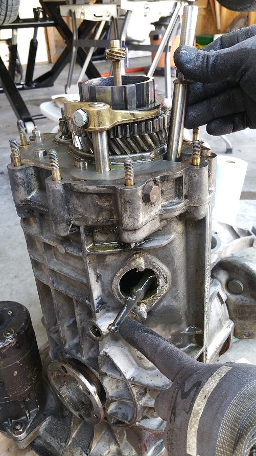

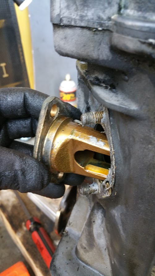

Moving along....I removed the side cover plate which is attached to the fork piece.
I tried lifting the intermediate plate out of the case, but it would lift up maybe 2 inches before encountering resistance. I called Brad Mayeur and he said to press the end of the shift rod for 2nd/3rd gear a little bit (the lower one that just protrudes out the int. plate, just above the rod for 1st/rev). I did that and the whole plate and guts lifted right out. Awesome!

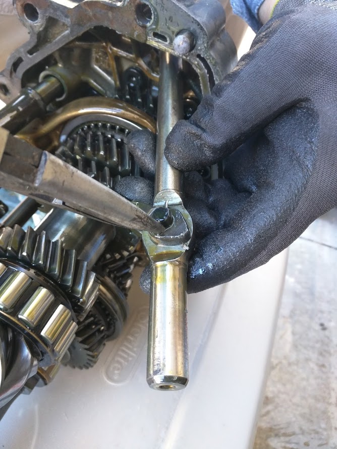

With the gears out, I could disassemble the internal shift rod by removing the cotter pin and driving out the pin. This was a little tricky. Thankfully I had a helper to hold the rod steady while I drove it out with a punch and hammer.

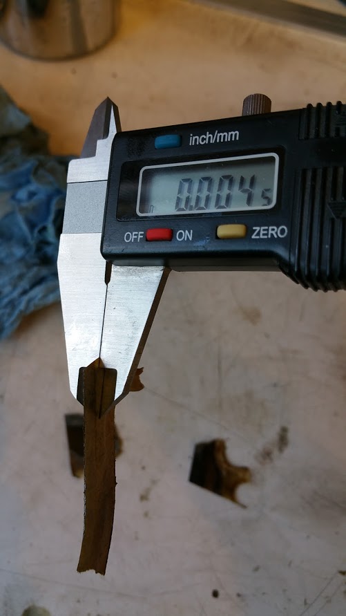

With the intermediate plate out I carefully measured the two gaskets from a section of the casting that fell between the bearing surfaces to get a good measurement from gasket that had not been compressed. It was still a bit tricky. One round of measuring showed one shim at .005 and one at .004. Another round of measuring showed .004 and .003. So I'm not sure what I've got here. I'll try again. Not sure what the tolerances here are, as the Haynes manual doesn't mention this. I'll do a little searching.
