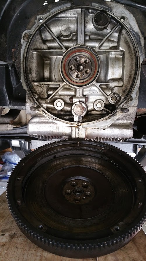

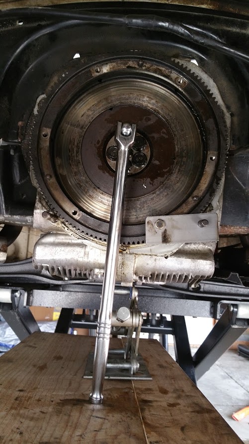

I did get the flywheel off this morning after making a quick and dirty locking plate. I like not having to deal with a 300lb. torqued gland nut! The five bolts came off relatively easily with my breaker bar.

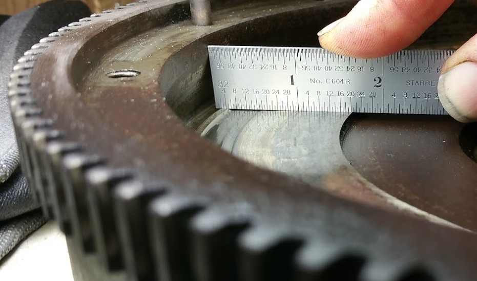

Cleaned up the flywheel and put a straight edge across the face. Wow. No wonder my clutch didn't feel very grippy. I hope I've got enough trough at the perimeter for a resurface. I was hoping to not have to buy a new flywheel.

Jameel   Dropped my flywheel off this morning, got it back ...   Mar 29 2016, 09:46 PM
mepstein   I just resurfaced mine for my six conversion. For ...   Mar 29 2016, 09:57 PM
Dr Evil   Things to consider: 1) Was the flywheel finished t...   Mar 29 2016, 10:41 PM
