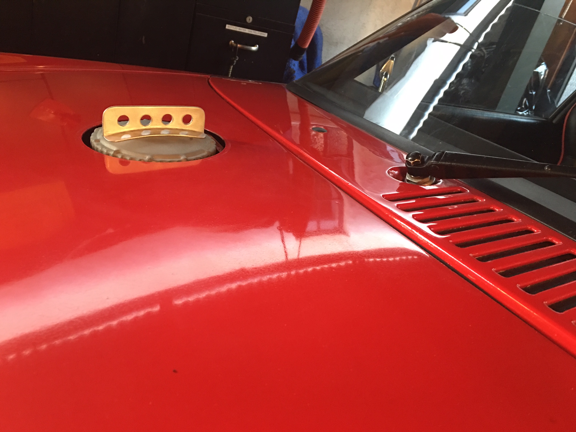

Hi,
that's prob the best pic I have of the mechanism currently - I built it to fit then stripped it down as I continue to work through the front of the chassis to fit the fuel tank & radiator - progress is slow due to house renovations :/
but I did refurb the steering rack, installing turbo tie rods & have the indicator / key wiring all figured out. have ordered bolts for to mount the indicator ring to the column ...
