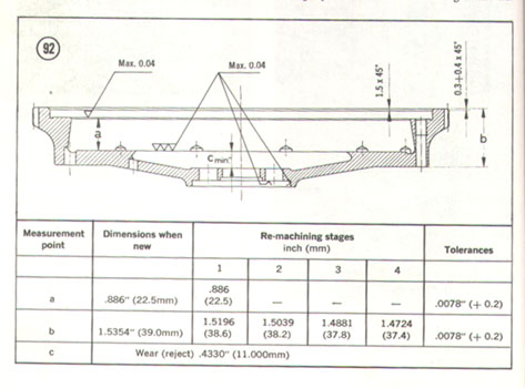

Jameel   Dropped my flywheel off this morning, got it back ...   Mar 29 2016, 09:46 PM
mepstein   I just resurfaced mine for my six conversion. For ...   Mar 29 2016, 09:57 PM
Dr Evil   Things to consider: 1) Was the flywheel finished t...   Mar 29 2016, 10:41 PM
