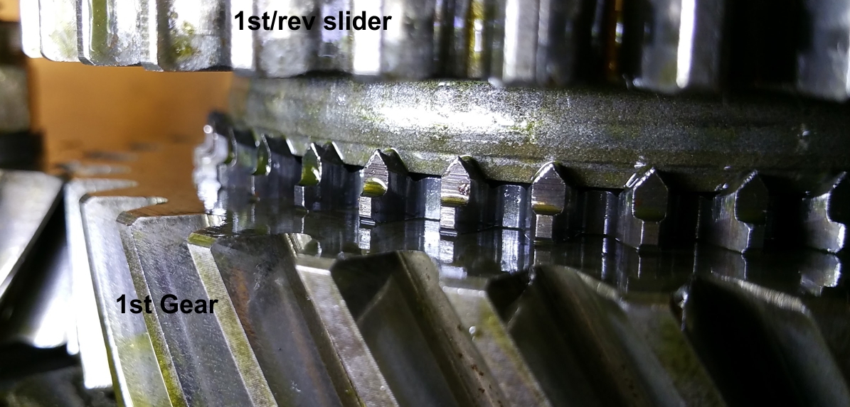

While studying the good Dr.'s DVD I've been trying to examine my trans without taking it completely apart. I'm just not ready for that yet. So here's some things I've observed so far.
First gear dog teeth look to be nice and pointed.

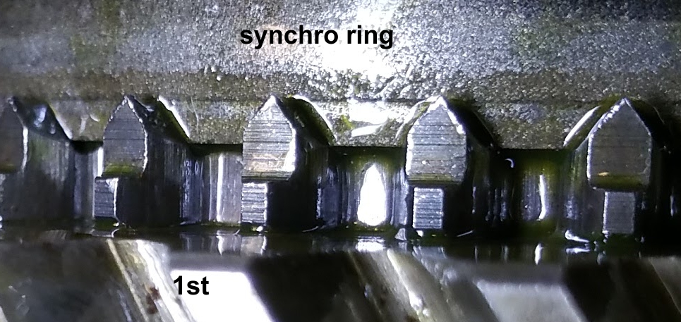

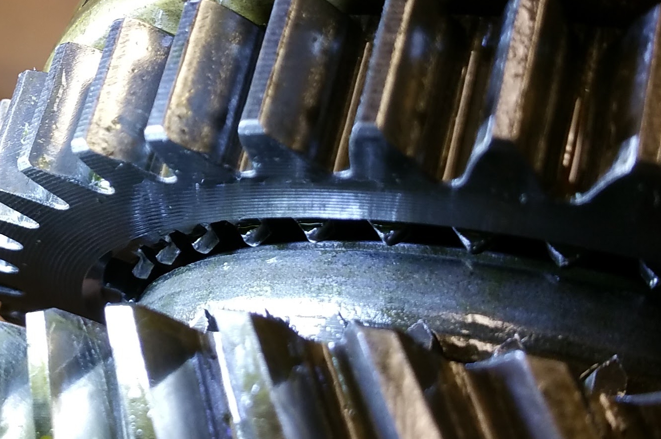

Here's another grouping of teeth. The synchro ring is worn.
The 1st/rev slider teeth are definitely worn in comparison.

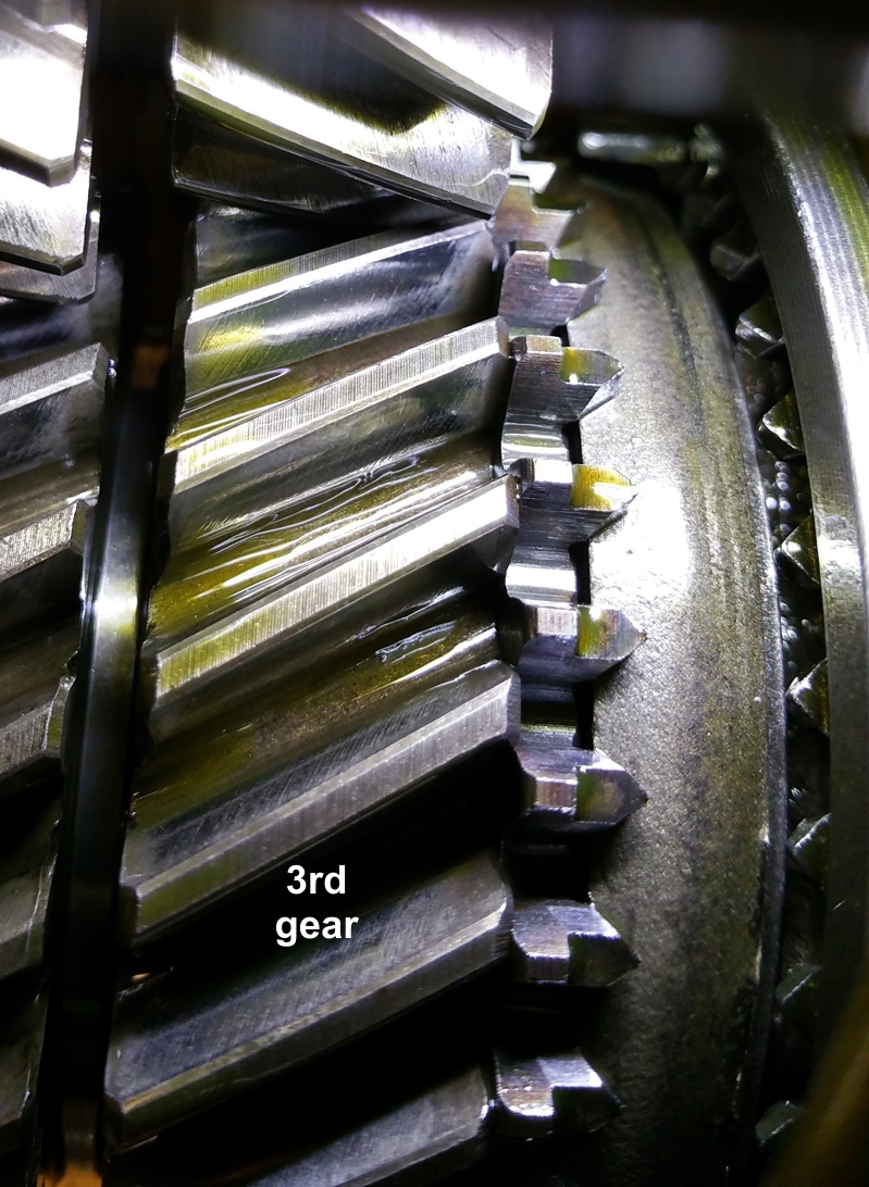

And here are the 3rd gear teeth.

stugray   The dog teeth in those pics look pretty good. One...   Mar 31 2016, 07:17 PM
Jameel   The dog teeth in those pics look pretty good. On...   Apr 6 2016, 08:30 AM

Dr Evil   Yer teeth are worn. Like saggy roofs. Look to the ...   Apr 6 2016, 09:29 PM
Jameel   Yer teeth are worn. Like saggy roofs. Look to the...   Apr 7 2016, 06:19 AM
