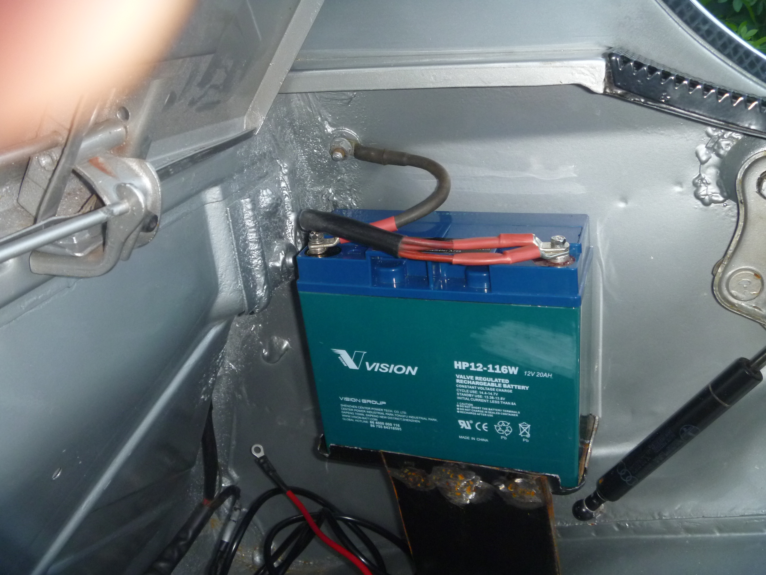

Tiny little one race car spec but packs a punch,have been using it for electrical testing and amazed at it,may stay with it if it cranks my 2.2T motor,made temporary battery tray.
If it doesn't suit my needs it will go to my rideon mower for an outlay of $59nzd I really don't care.
