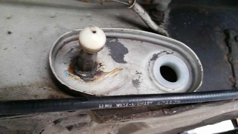

A few days ago I decided to take a closer look at my shift linkage, since my car has some serious issues. Took that rear cover off and found this: https://youtu.be/gtFysPUBIO0
I'm no engineer, but that looks nasty to me. I decided to fix it right.
So yesterday I made a trip to 914 Limited and was treated quite well by Brad and Mike. Brad and I had exchanged a couple emails and calls and since I'm less than 3 hours from Peoria, I decided to kill two birds and simply drive in. Brad was kind enough to let me drive his daily 914 to see what a side shifter felt like. Took me about 1/3 mile to decide I would do the conversion. Brad and Mike walked me through a few of the finer points of the process, but this being my first time opening up a transaxle, I figured I'd try and document as much as possible.
I've done a bunch of searches here (and at Pelican) but have not found much in terms of step-by-step. Brad's instructions were provided, and he invited me to call anytime for support, but I'll be taking pics anyway, so figured I'd start a thread.
Can anyone point me to a thread where someone has documented the process? The best I've found so far is mikedsilva's, here. I could not find others.

The dog teeth in those pics look pretty good.
One more thing to consider checking:
When I installed the side shift in a tail shift car, I also installed a rennshifter.
When the shifter was in the extreme 4th/5th plane, the bottom of the lever on the rennshifter was dragging on the clutch cable tube.
I ground the side of the rennshifter a little and moved the shifter up 1/4" with an aluminum plate.
I was reminded of this when I was in my tunnel checking for a clearance issue where you cut into the tunnel above.
There WAS an interference at that point you identified, so I enlarged that hole a little towards the driver's side.
I used a 3" hole saw instead of your angle grinder above and had enough room to fit a 90deg porting tool in there.
Thanks for showing that or I wouldnt have known to check it.
I always could hear something rubbing beside the seat when I shifted it without the engine drowning out the sound
