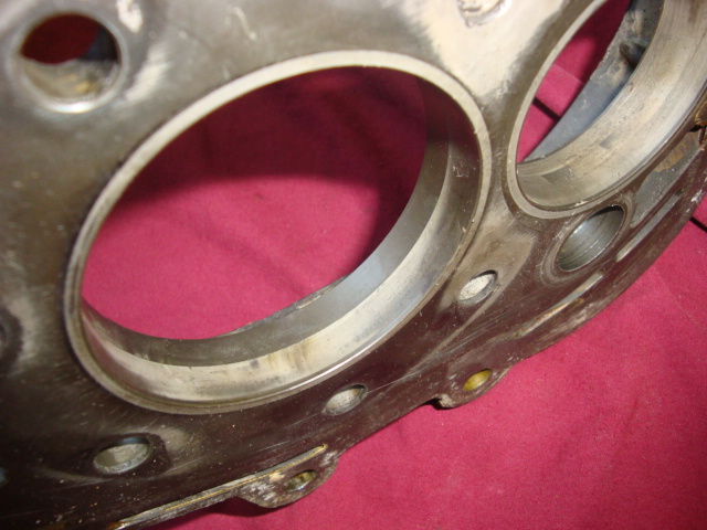

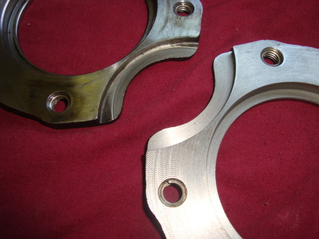

Your March 31st video shows visible end play on your pinion shaft. If you can feel end play, it is too much; if you can see the play, it is way too much.
The pinion bearing is probably turning in the intermediate plate and has worn into the retaining plate. The plate should clamp the bearing with about 0.08mm preload. The attached picture shows a clamping plate with wear on the mainshaft bearing retaining area. The mainshaft bearing turns first because it is not clamped well; the pinion shaft bearing follows. You need to replace the retaining plate and will probably the intermediate plate as well. Attached ImageAttached Image
