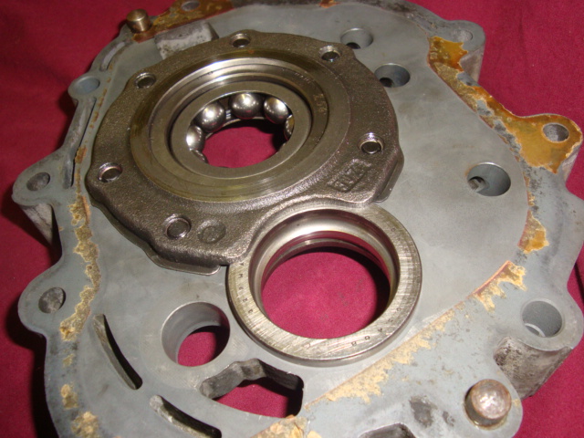

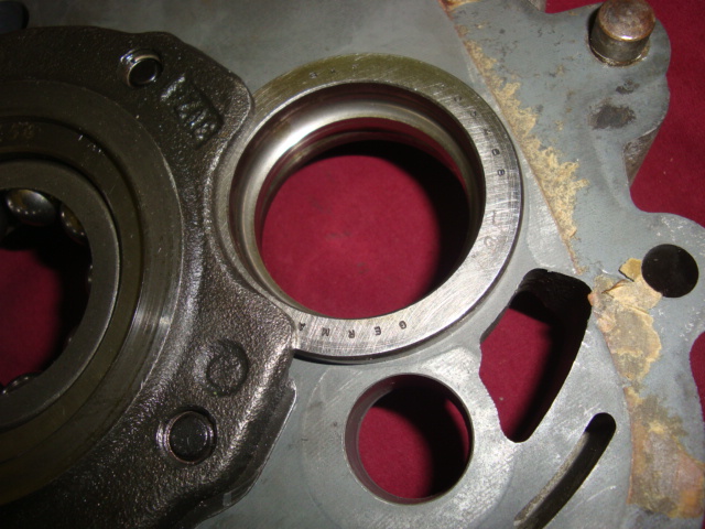

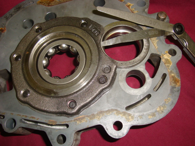

oldie914   Your March 31st video shows visible end play on yo...   Apr 7 2016, 01:52 AM
oldie914   Here are some more pictures showing indicators of ...   Apr 7 2016, 03:27 AM
Jameel   Thanks for the tips oldie914. I'll look closer...   Apr 7 2016, 06:42 AM
