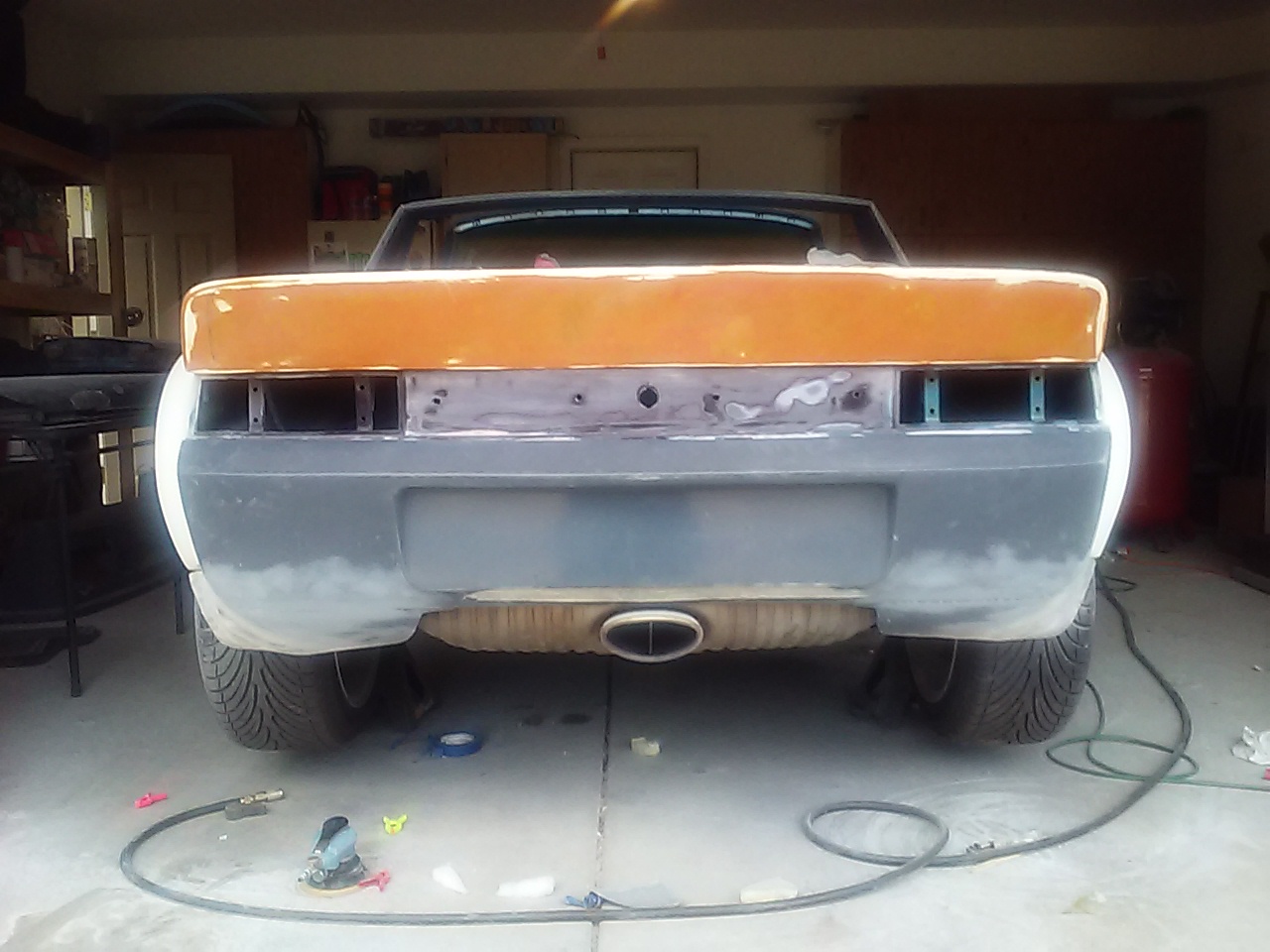

raw1298   Started on rear bumper today. Two step process. Fi...   Apr 7 2016, 03:15 PM
raw1298   A little filler....   Apr 7 2016, 03:18 PM
raw1298   Few rough patches, but not bad for a rookie like m...   Apr 7 2016, 03:48 PM
raw1298   Ran somE 40 grit over it to smooth out. I have som...   Apr 7 2016, 04:14 PM
