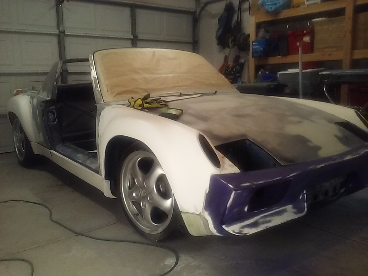

raw1298   Starting to fabricate flares into the bumpers. Usi...   Nov 14 2015, 03:22 PM
raw1298   After forming the foam and coating with bondo its ...   Apr 6 2016, 01:26 PM
raw1298   Starting rear bumper mods.   Apr 6 2016, 01:28 PM
raw1298   Rockers are next.   Apr 6 2016, 01:29 PM

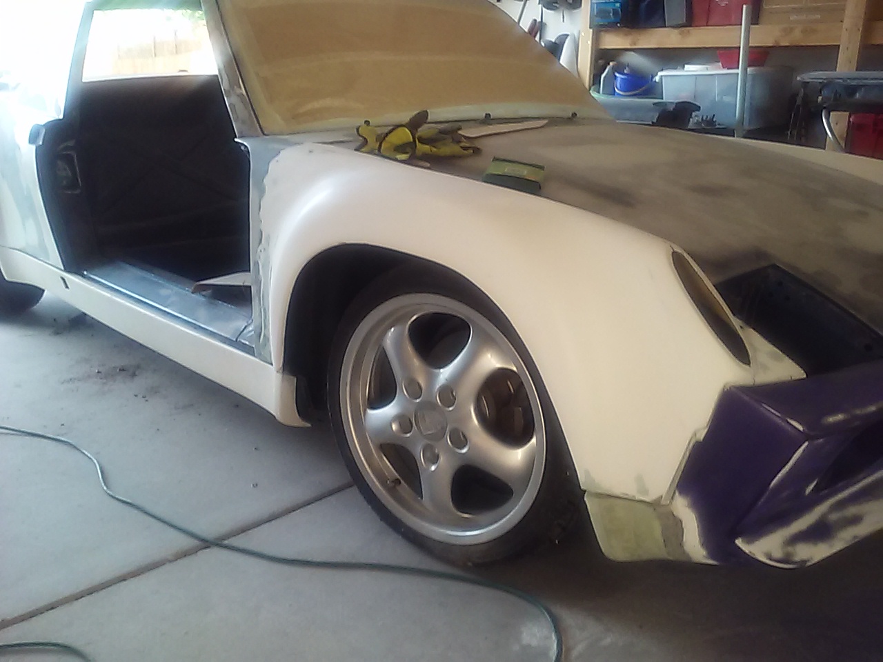

raw1298   Started on rear bumper today. Two step process. Fi...   Apr 7 2016, 03:15 PM
raw1298   A little filler....   Apr 7 2016, 03:18 PM
raw1298   Few rough patches, but not bad for a rookie like m...   Apr 7 2016, 03:48 PM
raw1298   Ran somE 40 grit over it to smooth out. I have som...   Apr 7 2016, 04:14 PM
raw1298   Side view.   Apr 7 2016, 04:21 PM
raw1298   I am really liking the way this is heading. Time f...   Apr 7 2016, 04:35 PM
raw1298   One more. :D   Apr 7 2016, 04:40 PM
raw1298   After attempting to get the rockers to line up I d...   Apr 8 2016, 02:39 PM
raw1298   Another view.   Apr 8 2016, 02:41 PM
raw1298   Used foil tape over the fiberglass rockers then gl...   Apr 8 2016, 02:45 PM
