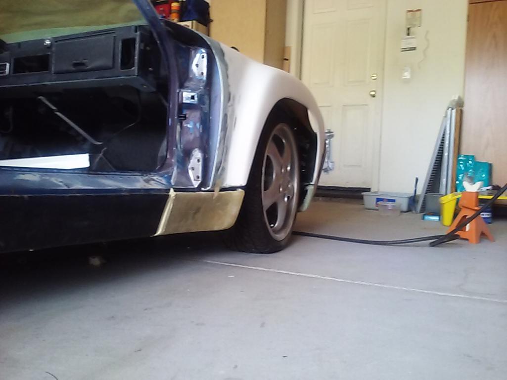

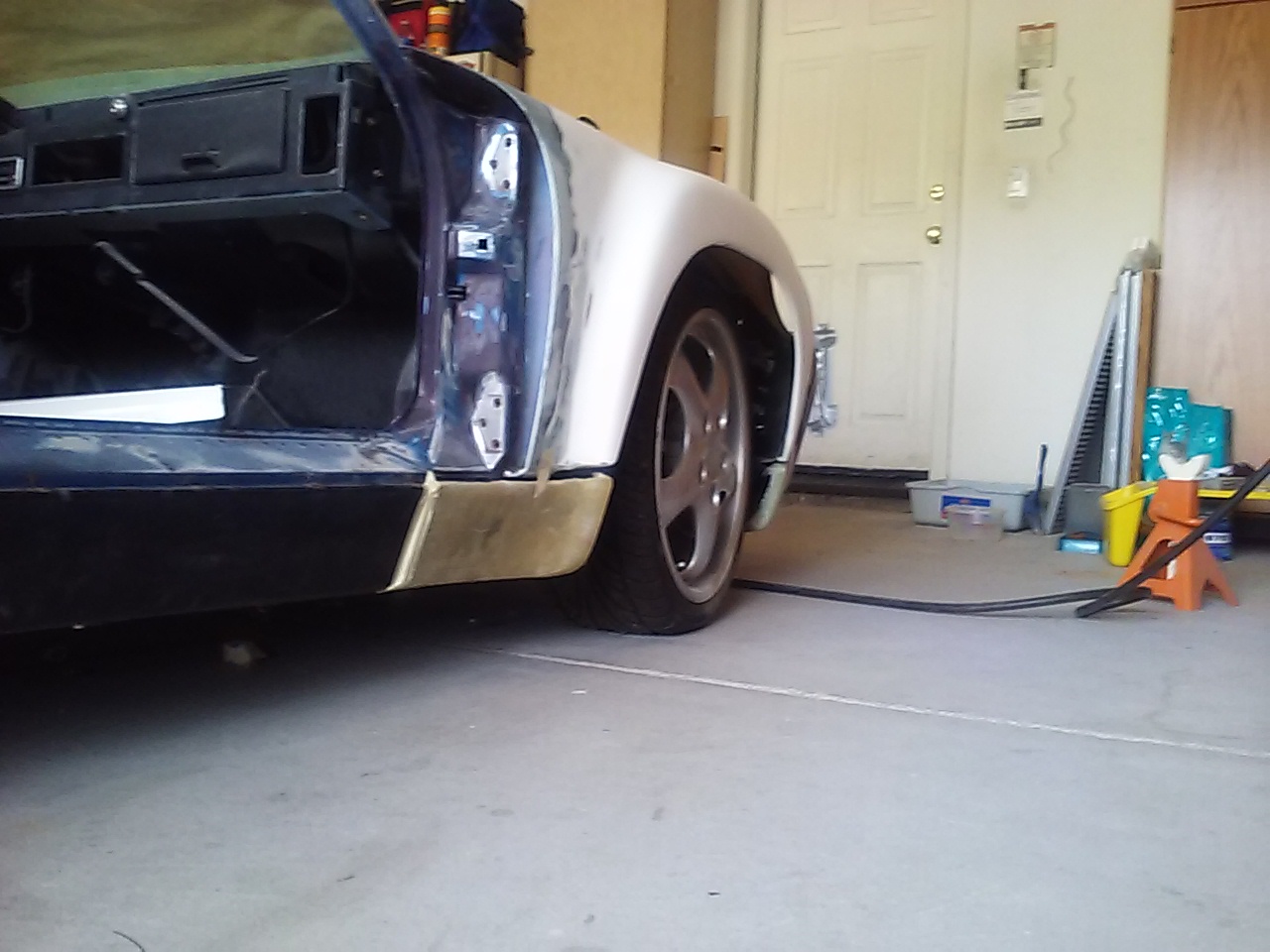

After attempting to get the rockers to line up I decided to try something different. I used the GT rockers do the mold and made ends to go on the metal rockers. What do you think? It is already closer than the glass ones.

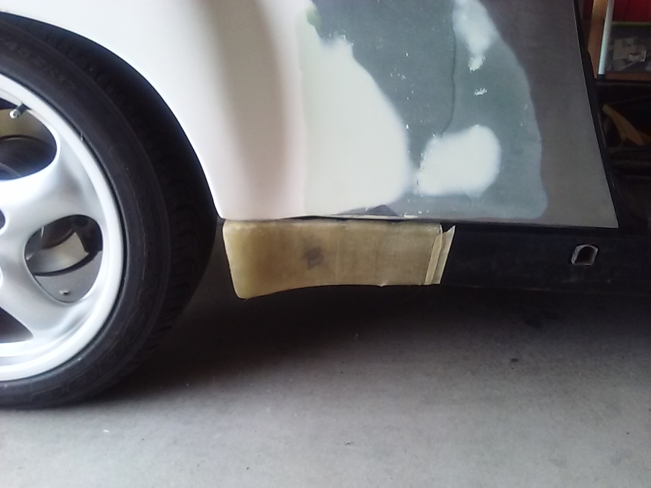

raw1298   After attempting to get the rockers to line up I d...   Apr 8 2016, 02:39 PM
raw1298   Another view.   Apr 8 2016, 02:41 PM
raw1298   Used foil tape over the fiberglass rockers then gl...   Apr 8 2016, 02:45 PM
