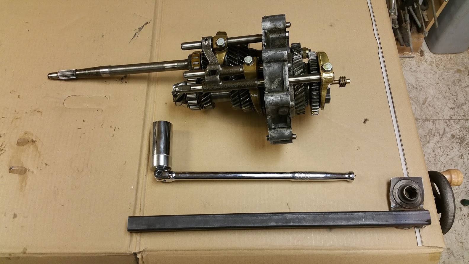

I grabbed my old clutch and hacksawed the rivets out, then had a friend weld up a drive shaft tool ala Dr. Evil. I see a welder in my future...

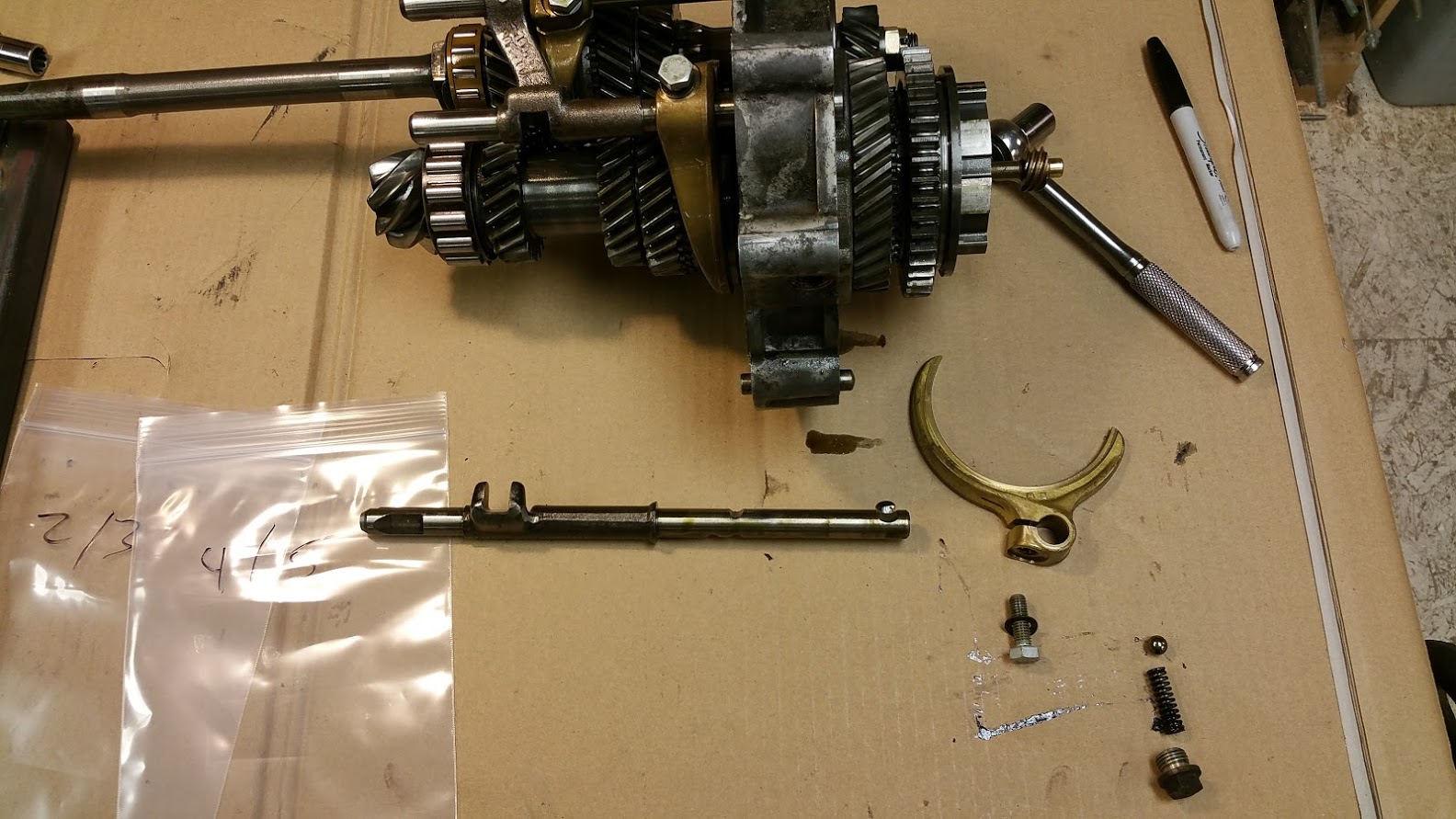

I've decided to replace 1st gear, 1st /rev slider and syncro band with a good used one from Brad Mayeur. So first step is to get the shift forks and rods off, along with the detent assembly. If you're a rank beginner like me, and you're reading this sometime in the future, just do yourself a favor and buy Dr. Evil's DVD. I won't be covering the assembly of the side shift rods and forks here because he obviously covers it better than I ever could. Plus, it's already a pain to try and shoot cell phone pics with gear oil all over my hands.

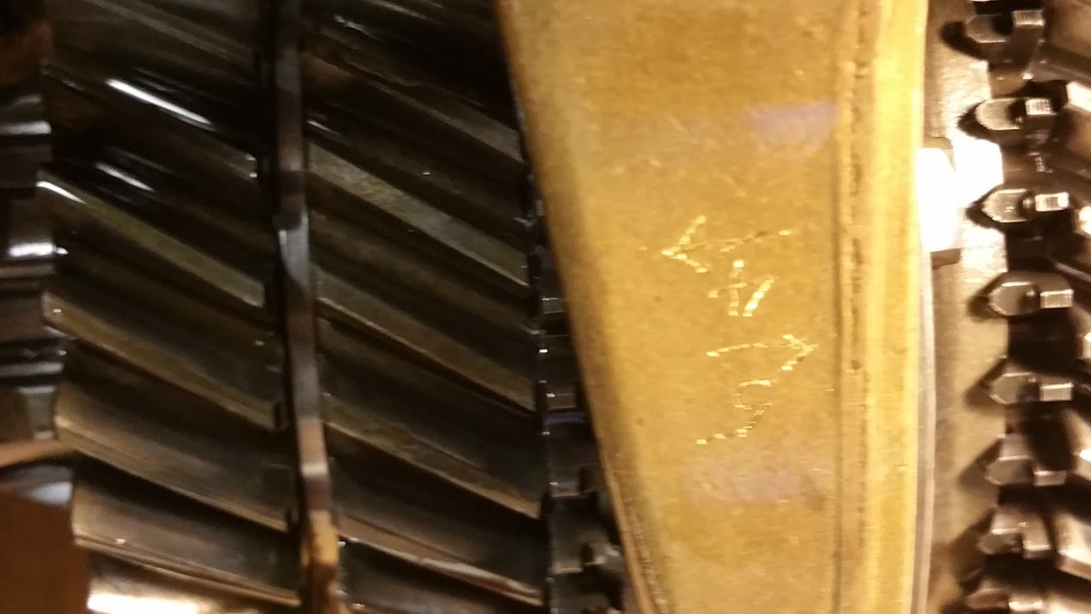

Someone has cracked this tranny open before I think. They scratched the numbers of the gears into the bronze shift forks. Thanks for that, whoever you are!

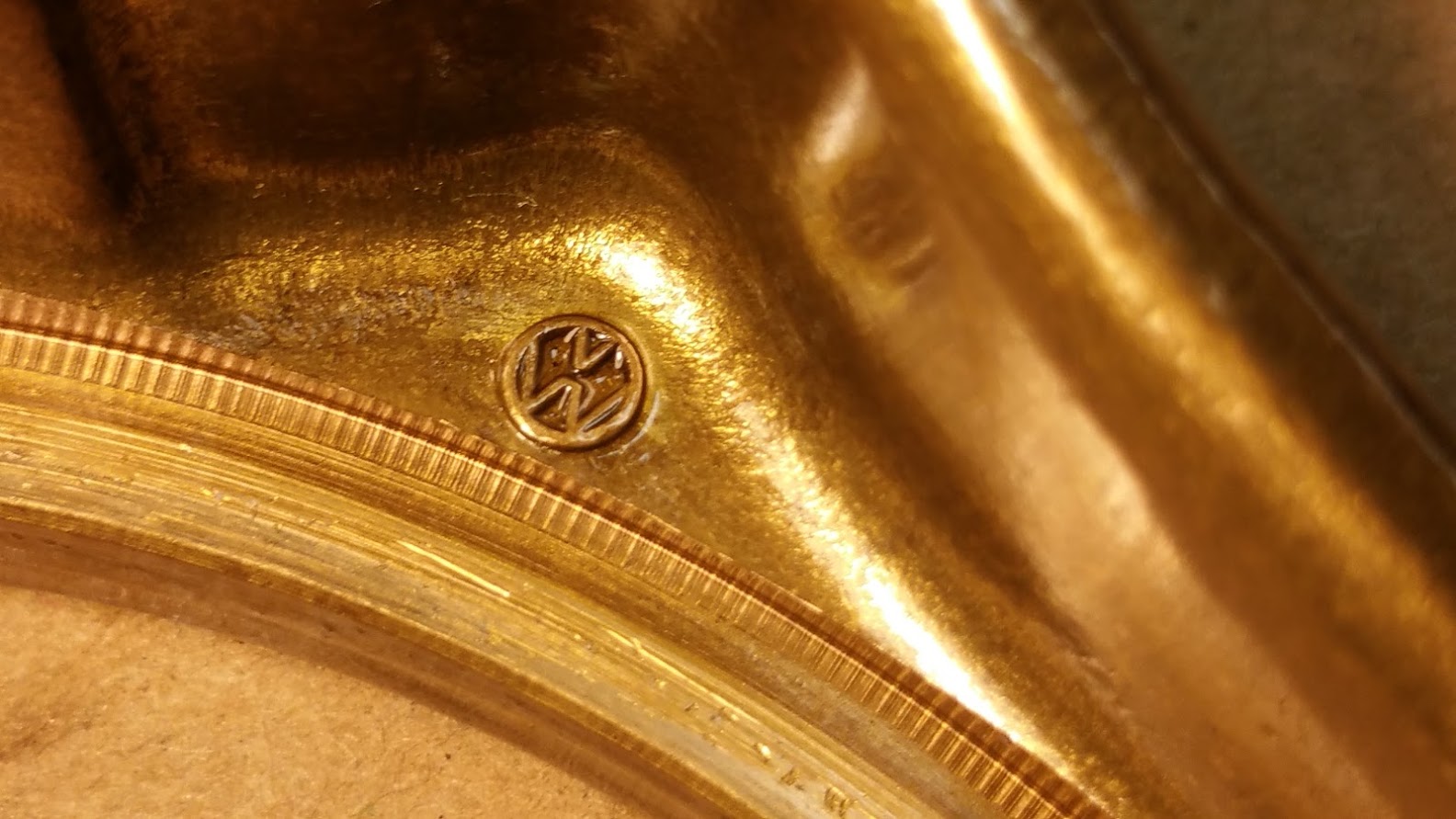

I was also surprised to see a Volkswagen symbol cast into the shift forks. Is this normal? I thought the 901 transmission was a Porsche product, same as the early 911's.

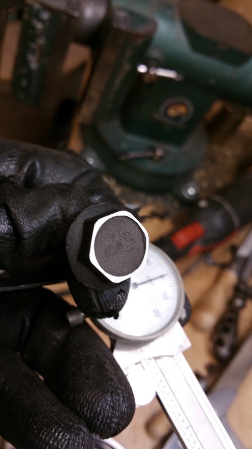

Started getting tired, so I pulled off the tranny and did a little grunt work. Since my flywheel got .023" removed to resurface, I ground at least .023" off the raised rim of the flywheel bolt heads so they don't interfere with the clutch.
