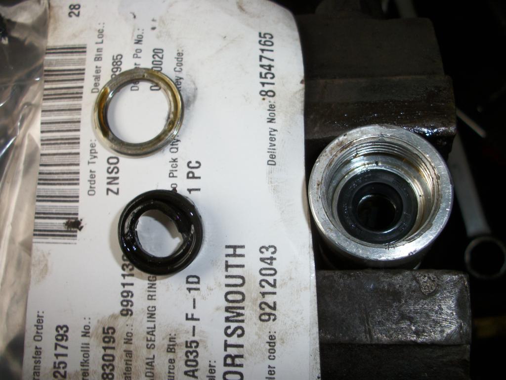

I'm having trouble getting this guy installed. It goes in fine, then when I tighten it up the shaft tightens up and won't turn (I'm turning the small gear inside the end of the tail cone) I did some careful measuring and I think the end of the slotted member in the angle drive is pressing against the shoulder of the paddle inside the tail cone piece. When testing the rotation of the angle drive itself I press down lightly on the arrowed surface and the drive won't turn, so I know it doesn't take much pressure here to prevent (what I assume are) the miter gears from turning.
The Haynes manual shows a whole grouping of parts as one number (frustrating!) Anybody know what A and B are? I'm thinking B is the seal, but what is A? I think a washer in here somewhere would provide a bit of clearance so things can move properly. Any ideas? ![]() |

Member ![]() ![]() Group: Members Posts: 392 Joined: 26-December 14 From: Chichester UK Member No.: 18,255 Region Association: England |
Both parts available from Porsche main dealers and still cheap.
(IMG:http://www.914world.com/bbs2/uploads_offsite/i265.photobucket.com-18255-1460374746.1.jpg) |

Jameel Thanks! You guys helped me figure it out. Yest... Apr 11 2016, 07:07 AM
