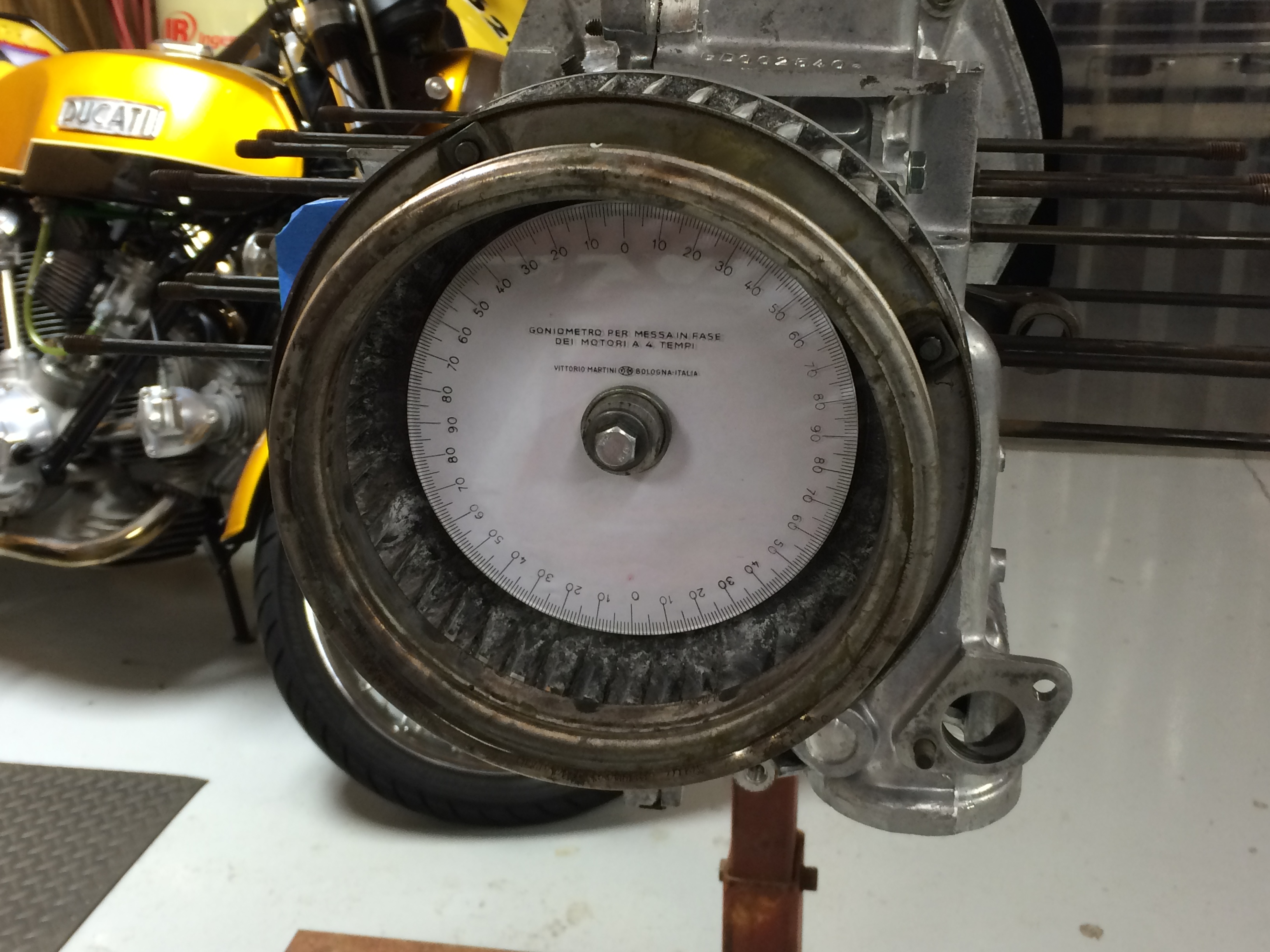

I decided I always need to know where my crank is - I mean - that's just a good idea...
Degree wheel is an old Ducati piece. Where we say "degree wheel" the Italians turn it into a song and say "goniometro per messa in fase dei motori a 4 tempi". I mean, it says it right on there. Rough translation = "goniometer for commissioning phase of the 4-stroke engines".
"Commissioning phase" - I like that...

sdoolin   I decided I always need to know where my crank is ...   Apr 11 2016, 05:35 PM
MarkV   So disregard pretty much everything I said. I foun...   Apr 11 2016, 05:39 PM
sdoolin   More fun finding TDC on #1. This fan from a bus (o...   Apr 11 2016, 05:43 PM
stugray   I suppose I need to make some marks so I can tim...   Apr 11 2016, 07:43 PM
