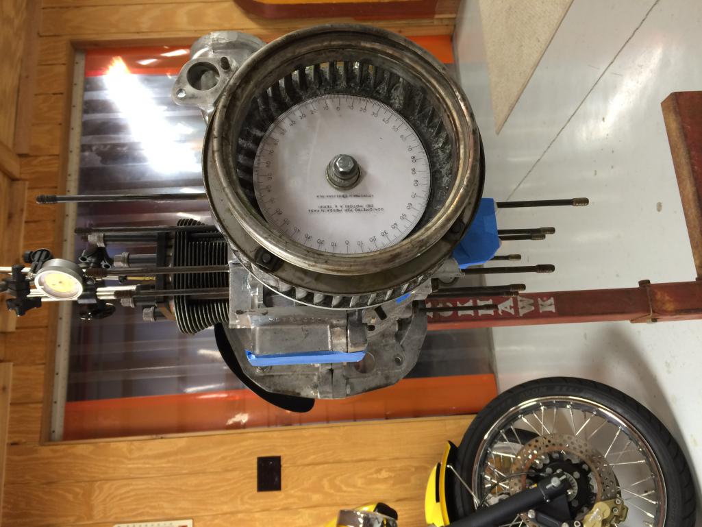

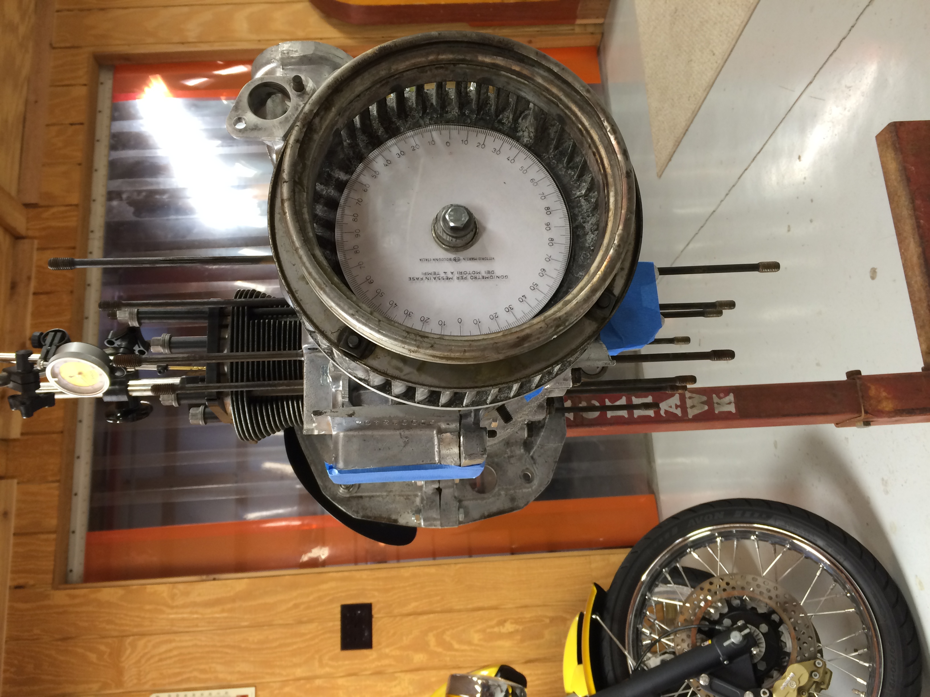

More fun finding TDC on #1. This fan from a bus (of course) so no marks on the fan itself, just a single mark on the pulley. That mark lines up at about 32 BTDC - which I think makes sense for a bus. You can barely see that mark (white dot) in the second image. Of course my pics will be rotated to appear as if I may have been standing on my head when I snapped them...
I suppose I need to make some marks so I can time this thing from the top through the timing sight in the fan shroud....
stugray
post Apr 11 2016, 07:43 PM
Posts: 3,825
Joined: 17-September 09
From: Longmont, CO
Member No.: 10,819
QUOTE(sdoolin @ Apr 11 2016, 05:43 PM) *
I time my engine from the rear using the flywheel marks.
There is (should be) a machined notch with white paint at TDC #1.
I made a yellow mark 180 degrees from that.
I can time my engine with the white mark thru the hole in the top front of the trans case, and I can set my valves from underneath using the white & yellow marks alternating as I rotate for each set of valves.
You can see the white mark here:
https://www.youtube.com/watch?v=QtPd5qzyTk8
I dont use the marks on the fan for anything anymore.
