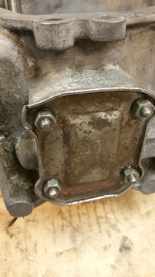

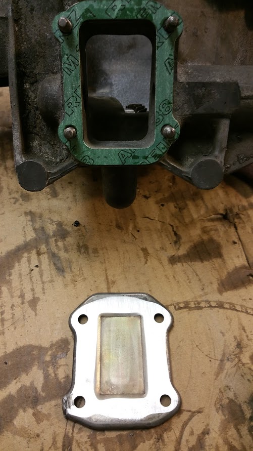

Putting my case back together I had to reuse the bottom rectangular plate from the tail cone of my tail shifter. The thing was a little beat up. Like someone had backed into a curb or something. The back edge was folder over a little, and the plate was far from flat on the gasket side. There were raised areas around each hole, like the plate got pulled away from the case.
Looks like someone tried to fix this with a cork gasket and a paper one together. My gasket set only came with one gasket, and it wasn't nearly thick enough to span the 1/16" gaps between studs on this plate.
So I went to the anvil and carefully peened around each hole from the outside of the plate with a 1/4 punch to flatten it. It worked really well. It still wasn't perfectly flat though. So I hit the inside face on my belt sander and then it flattened up real quick. Hopefully this will be leak proof.

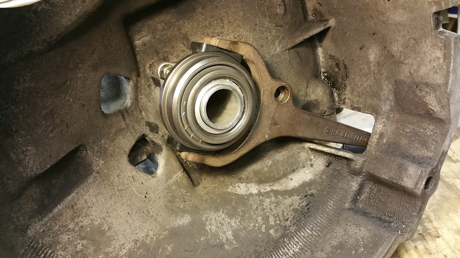

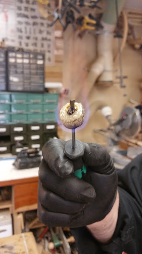

Also used Dr. Evil's method to get the cup out of the clutch throwout arm. PTFE S'mores anyone?

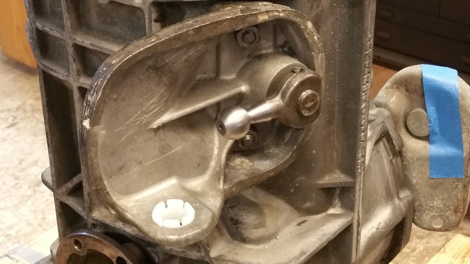

The last step was to install the new side shift console (I polished up the ball arm) and try and select the gears. I was able to select all gears pretty easily. They all clicked in real positively. I didn't feel any interference between the comb and the selector arms, so I must have got my spacing correct. This was so satisfying. I can't wait to shift this in the car!!
