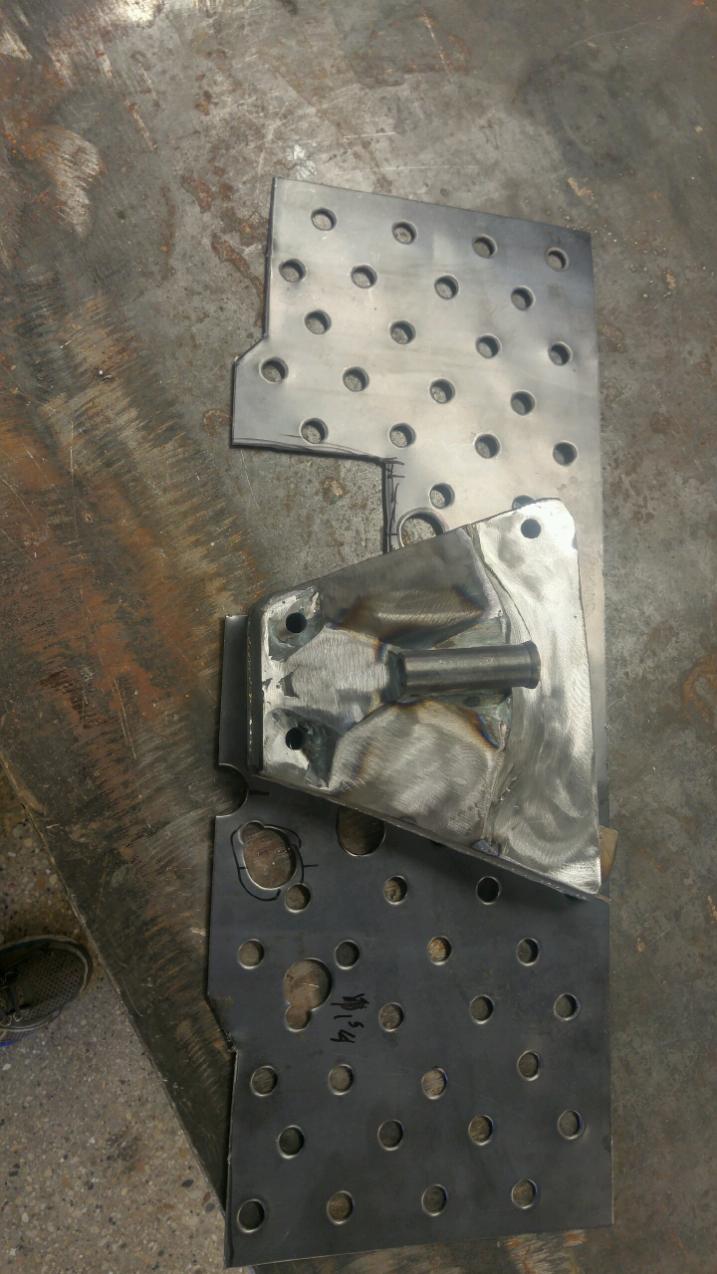

Well made some progress.. I have welded in some of the Gt chassis stifeners and cleaned some rust and painted with rust shield.. Its pretty waterey like por15 so got a run but that's fine I will have to sand before it gets color anyway.. I also built a stock looking six mount and a firewall reinforcement plate.. Will get some more work done on it shortly going to be off work for about a month coming upAttached Image Attached Image Attached Image
