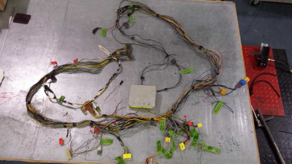

here is a pic of my harness with most sheathing removed.
there are a few good harness modification links on the internet but i am stumped at the moment as to what else i can cut off this harness.

1990 legacy 5spd

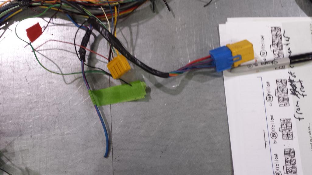

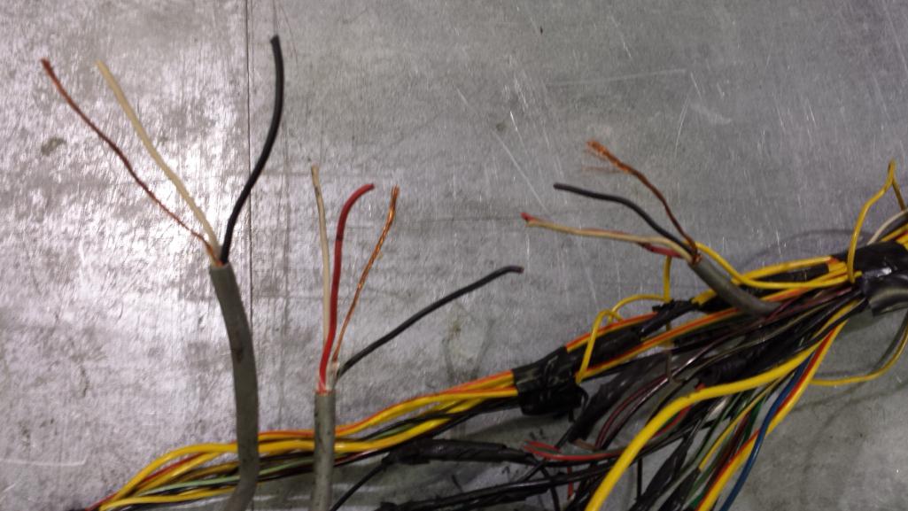

here is some progress, lots of wires removed, and some identified. i also botched up a few things, hope all are repairable.

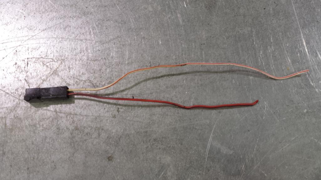

>>> my worst botch was cutting or disconnecting one of the engine plugs nearish to the ecu plug. these wires have one unsheathed wire (IMG:style_emoticons/default/blink.gif) and one seems to missing a red wire.
>>> such as where to wire in diode, i tried to keep it attached but then somehow it was gone and in my loose wires box. (IMG:style_emoticons/default/dry.gif)
i cut thru fat alt wires (IMG:style_emoticons/default/sad.gif) (* will just run a stand alone wire from alt to battery & wire up dummy light and guage later)
i also have a lot of soldering due to the bigger smj, and its wires i cut assuming most would be trash BUT most seem to be staying (IMG:style_emoticons/default/idea.gif) (* soldering done at this location for these many wires)
there is more but i think i made some good progress regardless.
jim
