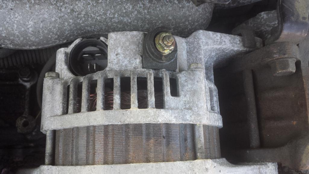

so one fat wire from alt to battery.
the other plug on alt is for dummy light and guage.
one problem conprehended (IMG:style_emoticons/default/biggrin.gif)
