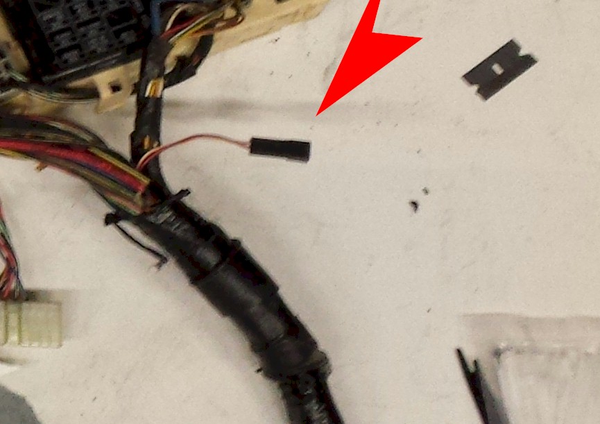

if this is a pic of diode on precut harness, its wires seems to run to one of the engine bay engine connectors. i should be able to verify tonight.

jimkelly   1990 legacy 5spd here is some progress, lots of w...   Apr 13 2016, 08:21 PM
Chris H.   Yep, you HAVE to find where that diode goes and pu...   Apr 13 2016, 09:48 PM
jimkelly   chris, thanks and i see your alt wire pic. are yo...   Apr 14 2016, 05:37 AM
jimkelly   so one fat wire from alt to battery. the other plu...   Apr 14 2016, 08:34 AM
jimkelly   if this is a pic of diode on precut harness, its w...   Apr 14 2016, 08:39 AM
