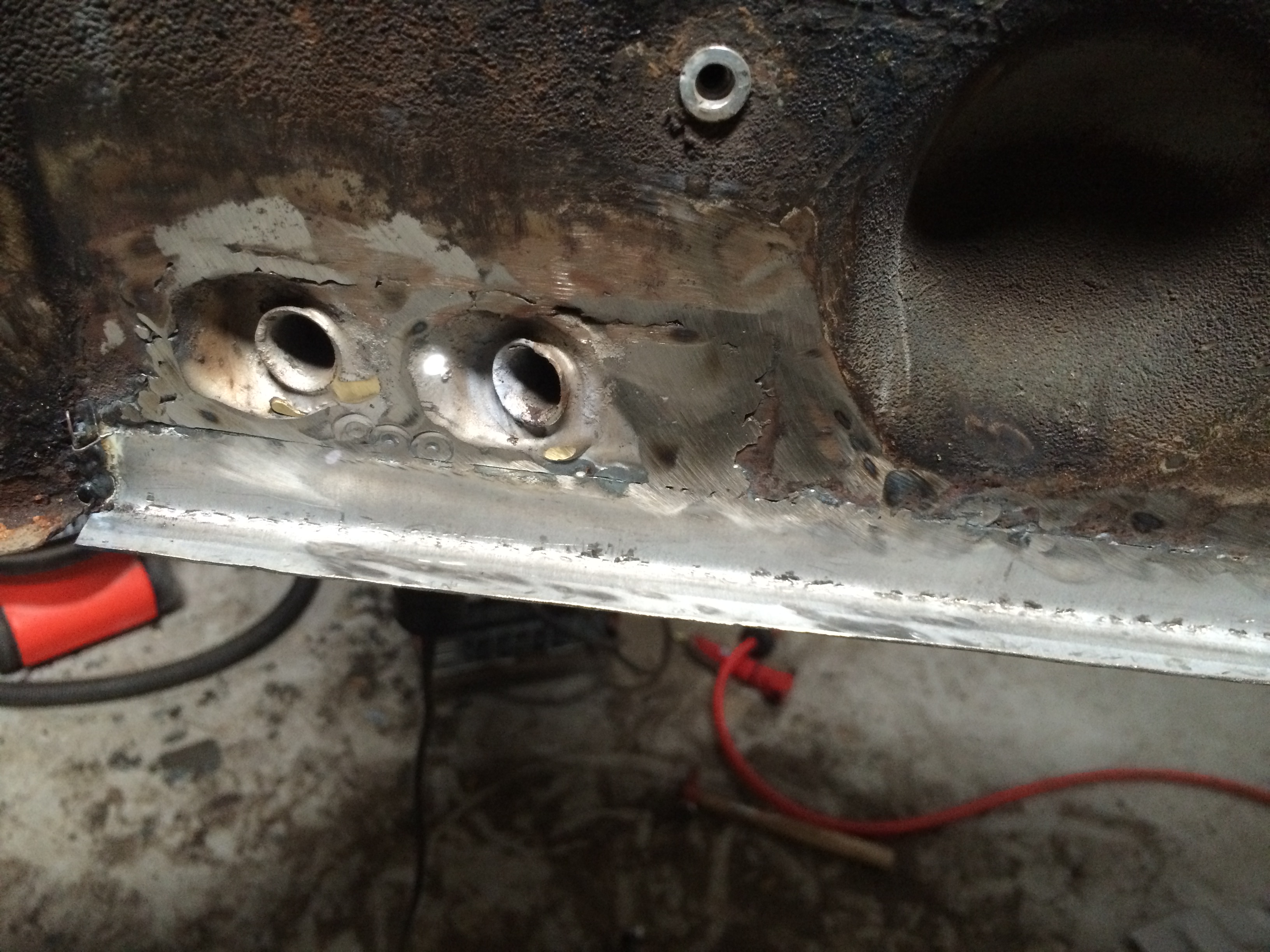

A couple of evenings has seen some progress ! I ended up removing the rear portion of the floor as it had been badly repaired in the past, so the guide tubes are in and a new lower edge fabricated and a portion of floor trimmed to suit
Floor in and tacked
Guide tubes on the proper side (IMG:style_emoticons/default/happy11.gif)
