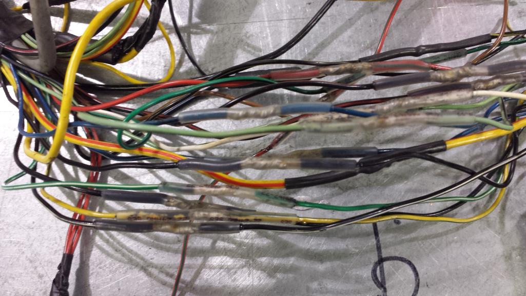

here is a pic of my harness with most sheathing removed.
there are a few good harness modification links on the internet but i am stumped at the moment as to what else i can cut off this harness.

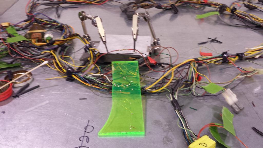

most wires i cut at smj soldered back up. gonna sit back down with harness to find the two wires for diode to connect to.
