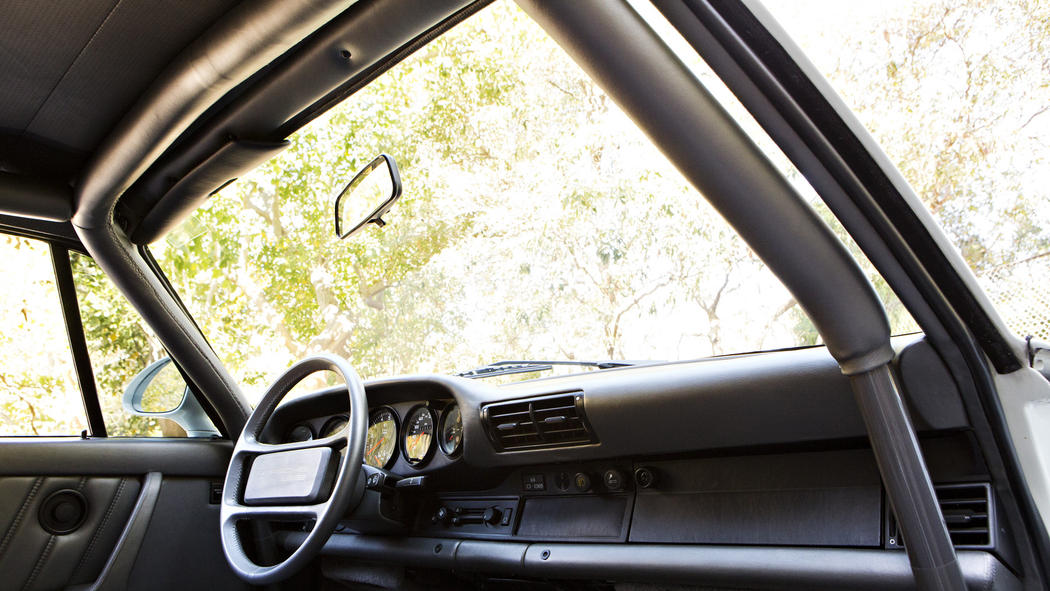

factory 959 (IMG:style_emoticons/default/beer3.gif)
