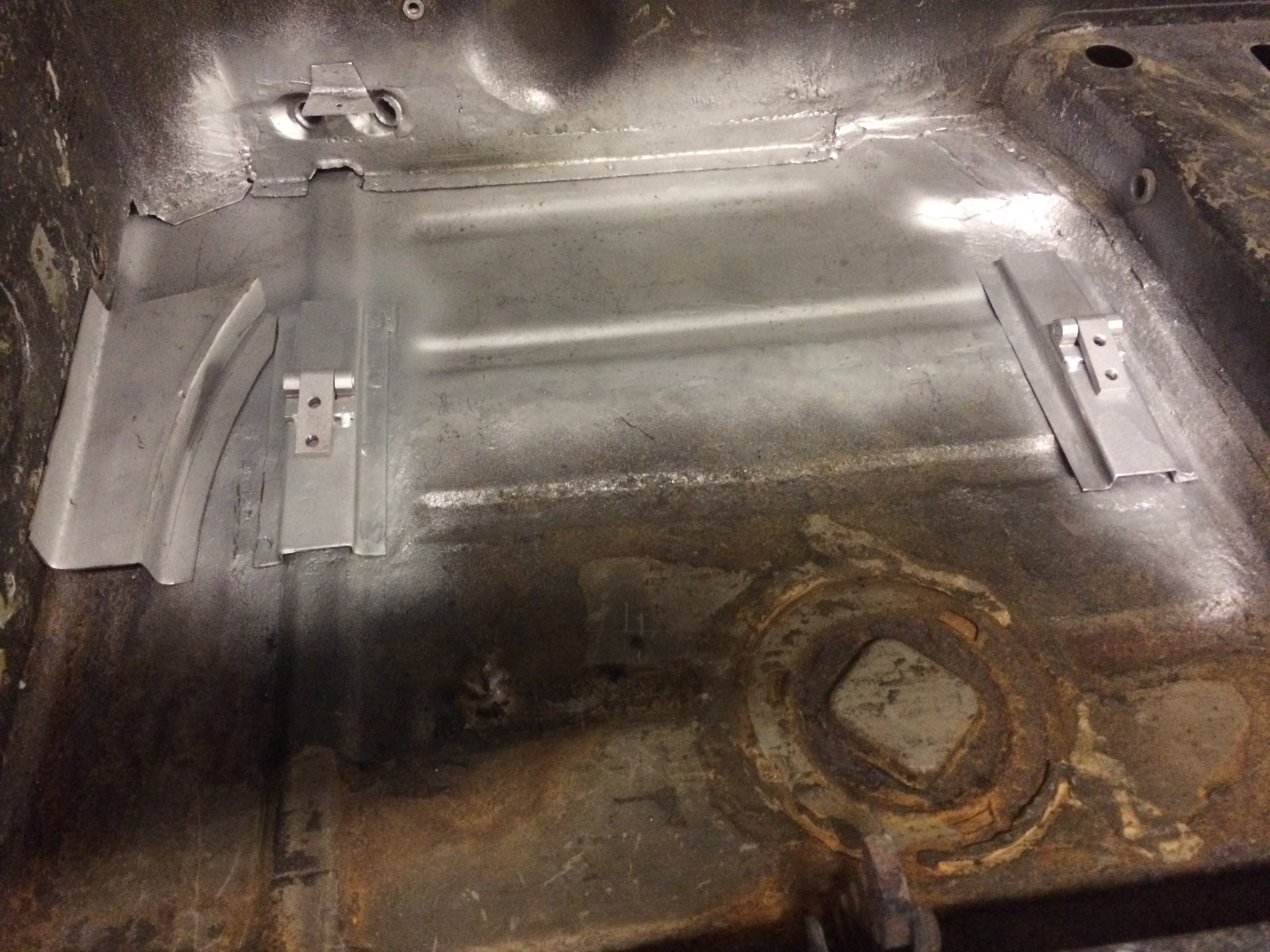

Yeah only two items left to do at the rear ! The hand brake mount and its associated dent in the inner long , I'm having to manufacture the hand brake mount as it's completely reversed!
A little bit of cleaning up to do oh and the floor reinforcement
