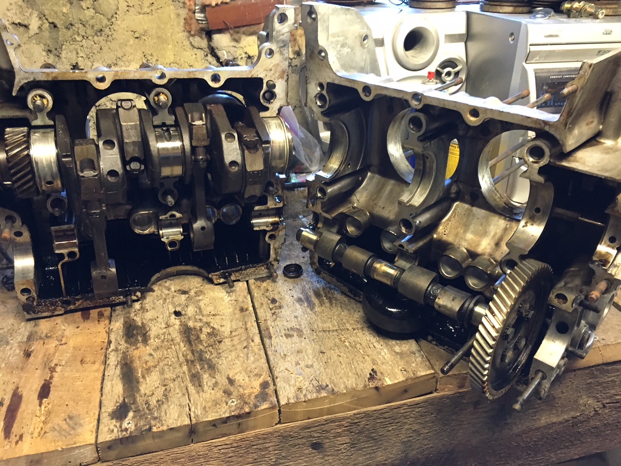

Finally some more progress!
Originally I hoped to just refresh the top end of the motor but upon checking out the motor some more, I decided to go ahead and split the case. There was a nice thick layer of sludge on the bottom so I'm glad I did.
Overall the motor was in pretty good shape though. All bearing surfaces looked great and there were no hidden surprises so the plan now is to clean everything up, replace bearings, and start assembly. I also took advantage of the situation and replaced the 5 main galley plugs.
