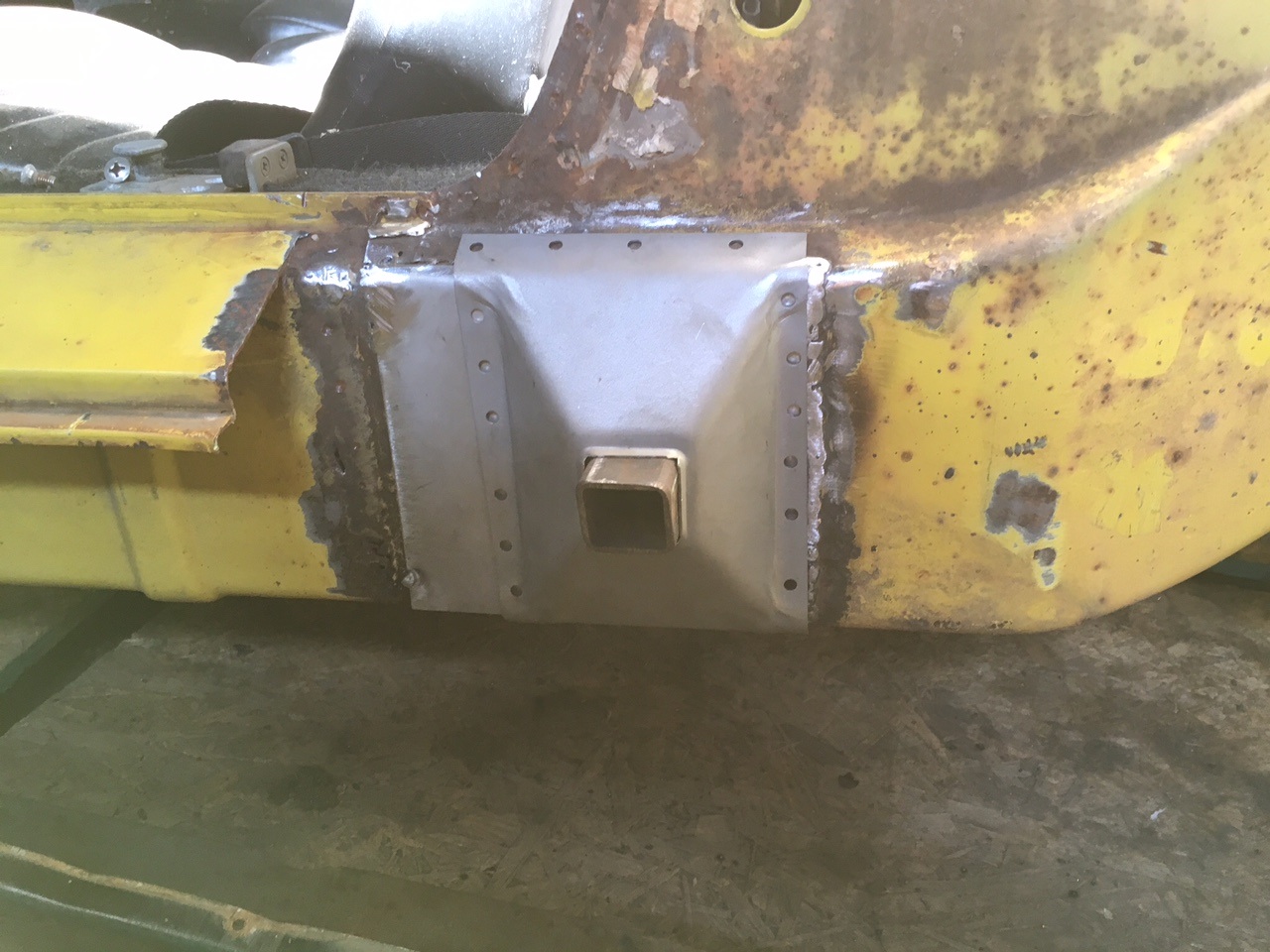

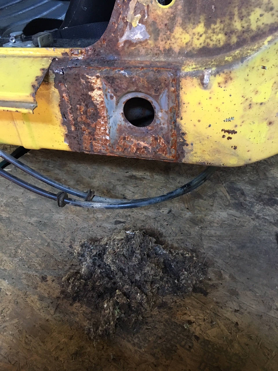

I also got some rust repair done on the driver's jack point and unfortunately I didn't take the best of pictures.
I started with this.
I then welded up a circle plate to cover the hole. The jack tube welds to this plate.

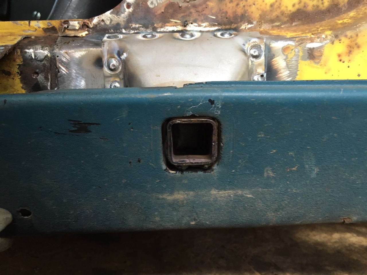

I then added a second layer and I cut a square hole in the middle for the jack tube.
I used a rocker panel to ensure everything lined up and then welded on the outer cover.
