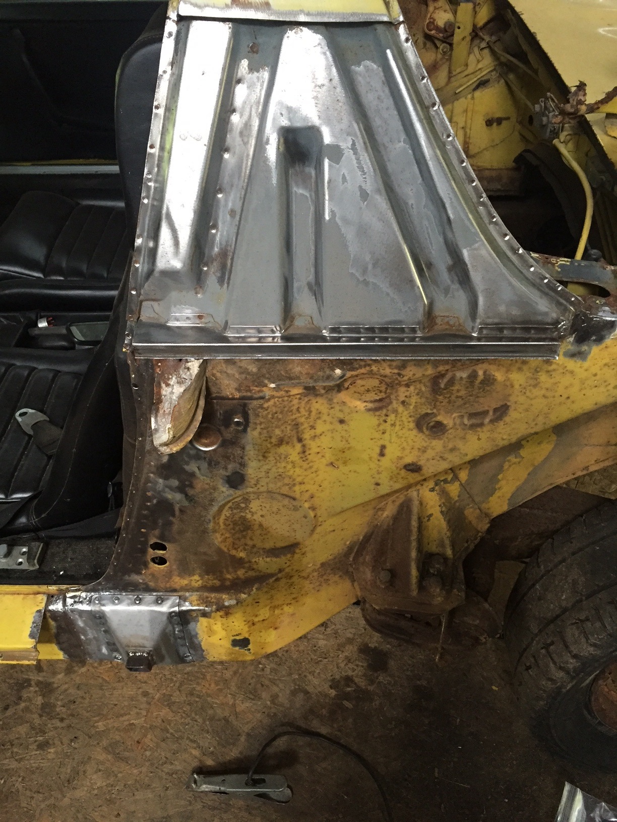

dlee6204   I finished by cleaning up the inner sail panel are...   Apr 21 2016, 06:46 PM

dlee6204   Today I was able to trim and fit the new sail pane...   Apr 23 2016, 02:34 PM
dlee6204   The replacement sail panel fit like a glove with v...   Apr 23 2016, 02:37 PM
dlee6204   One of the tasks I had to do to the door jamb was ...   Apr 23 2016, 02:43 PM
