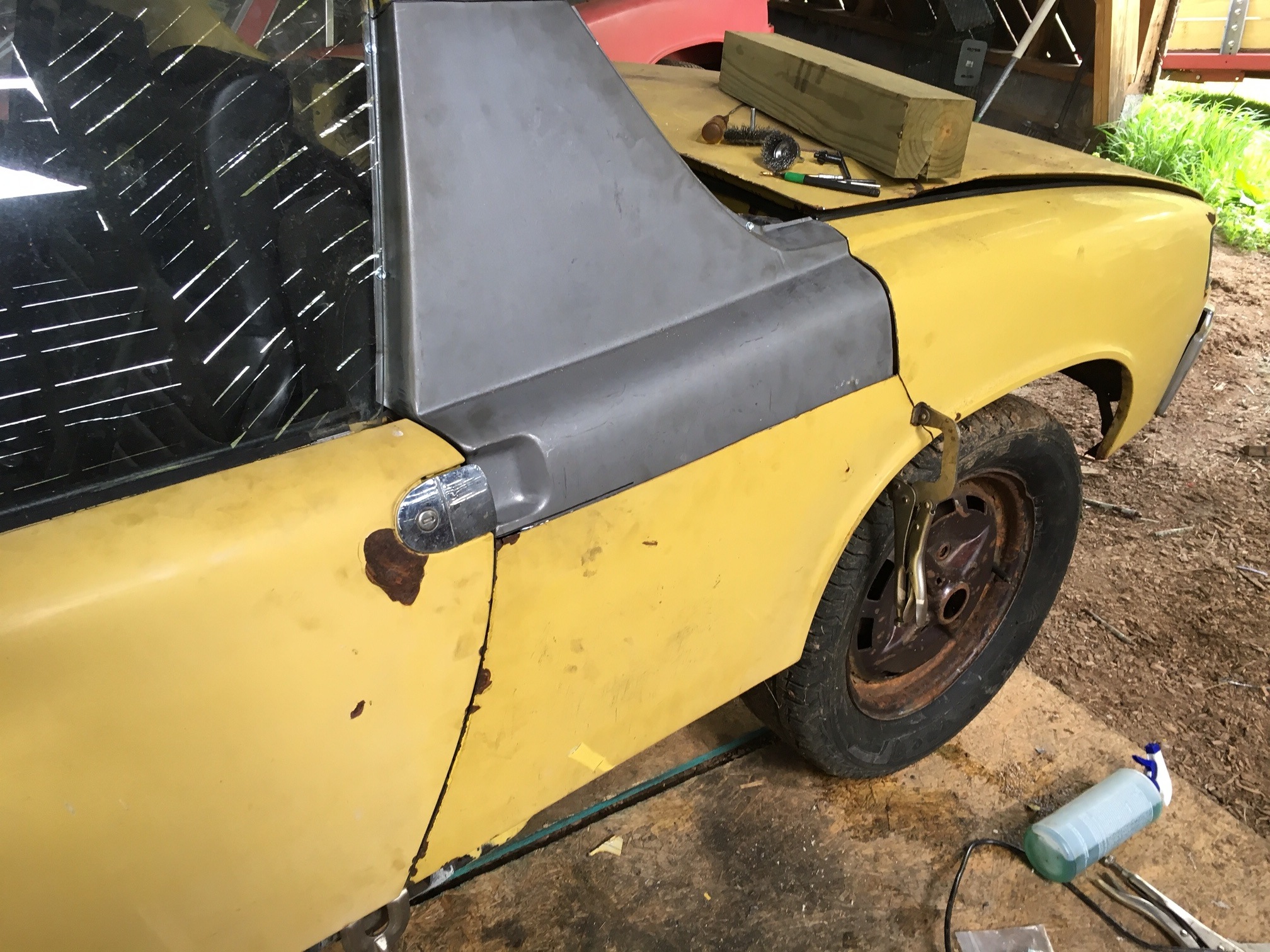

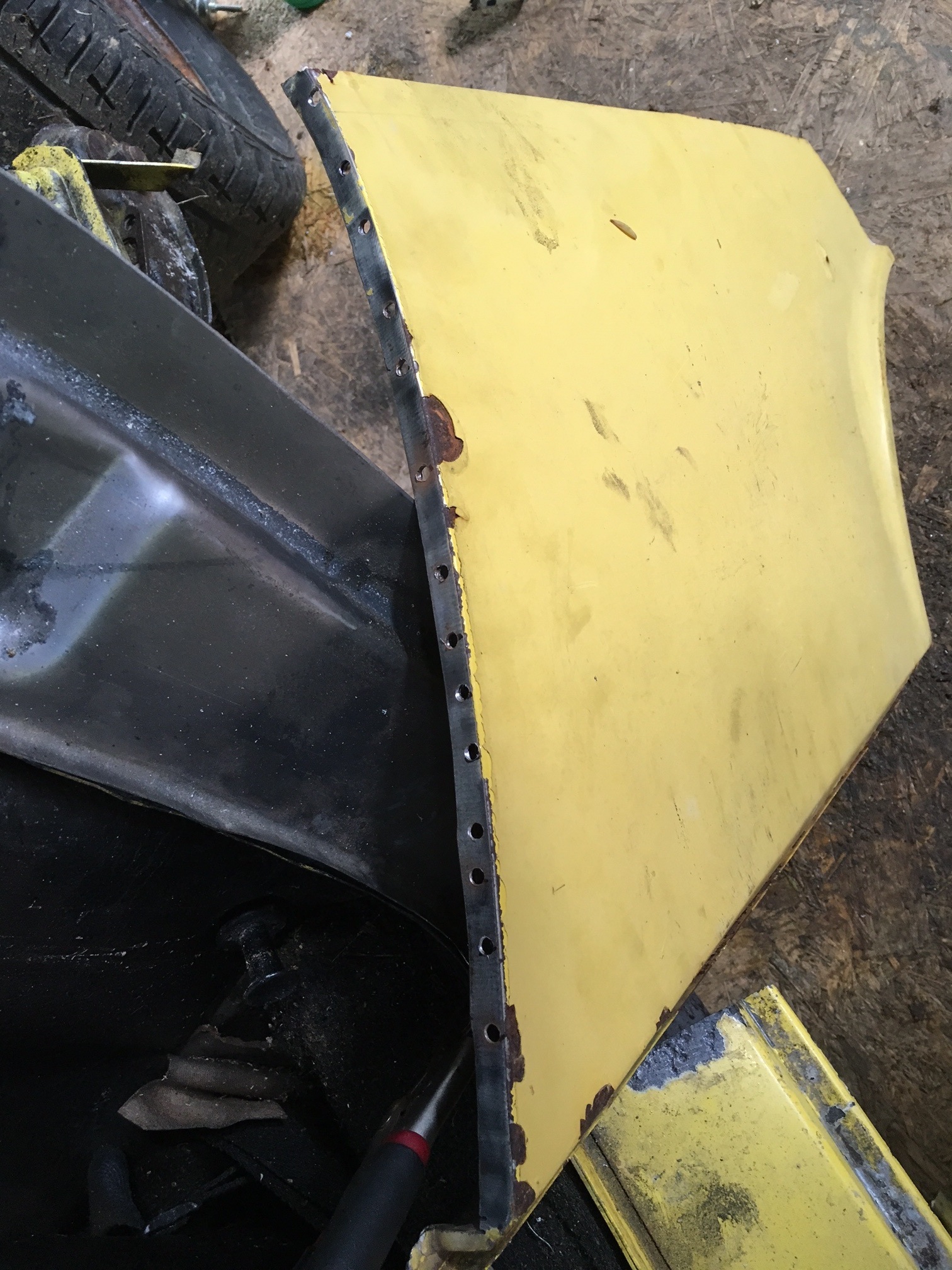

Today I was able to trim and fit the new sail panel, new door jamb, and the old section of fender. Taking my time and making one cut at a time, all the panels came together surprisingly well. Everything is currently held together with sheet metal screws and ready for welding. I'm going to apply primer to the back of everything before any welding happens. I still have to enlarge the vent hole.
