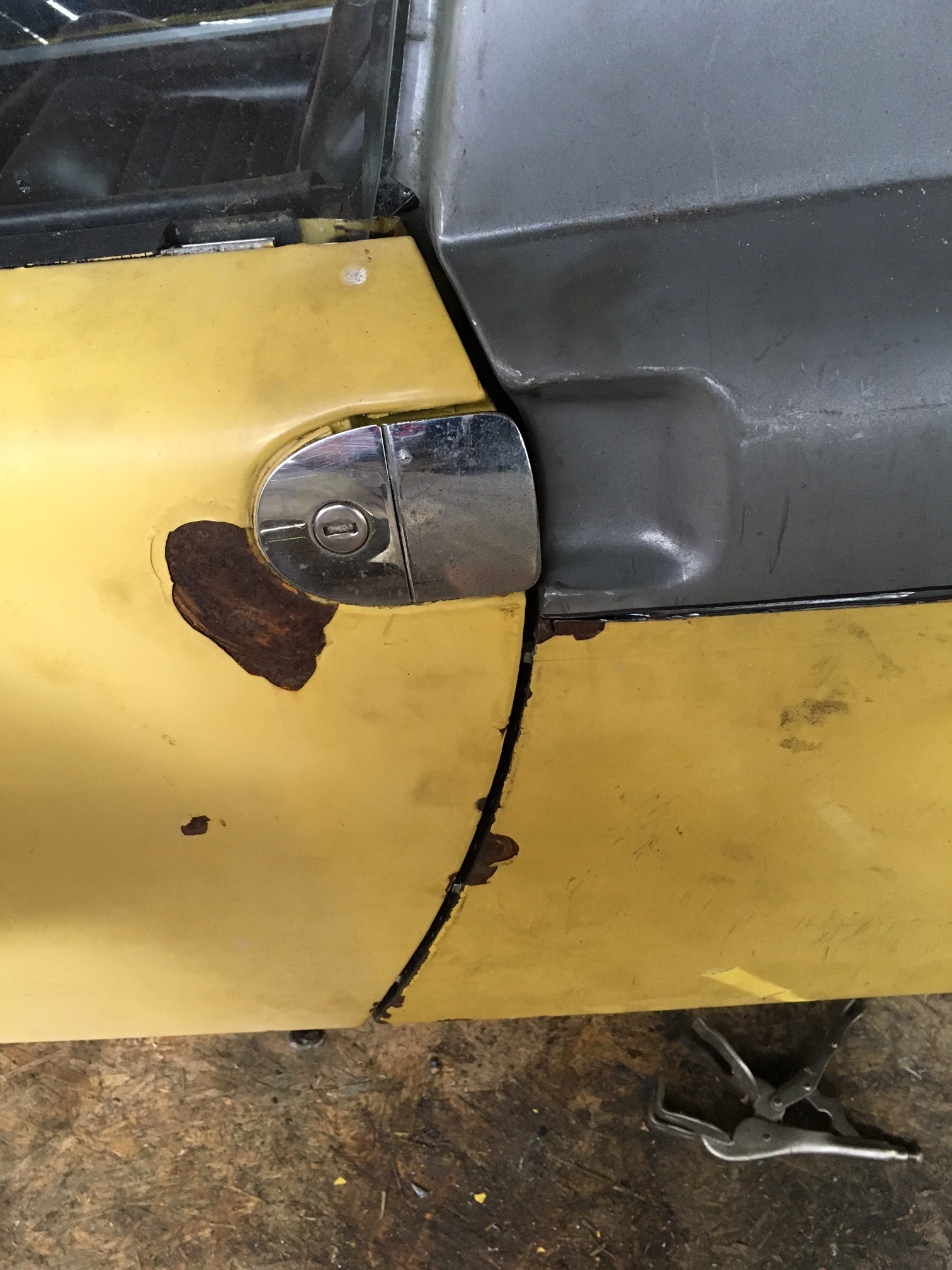

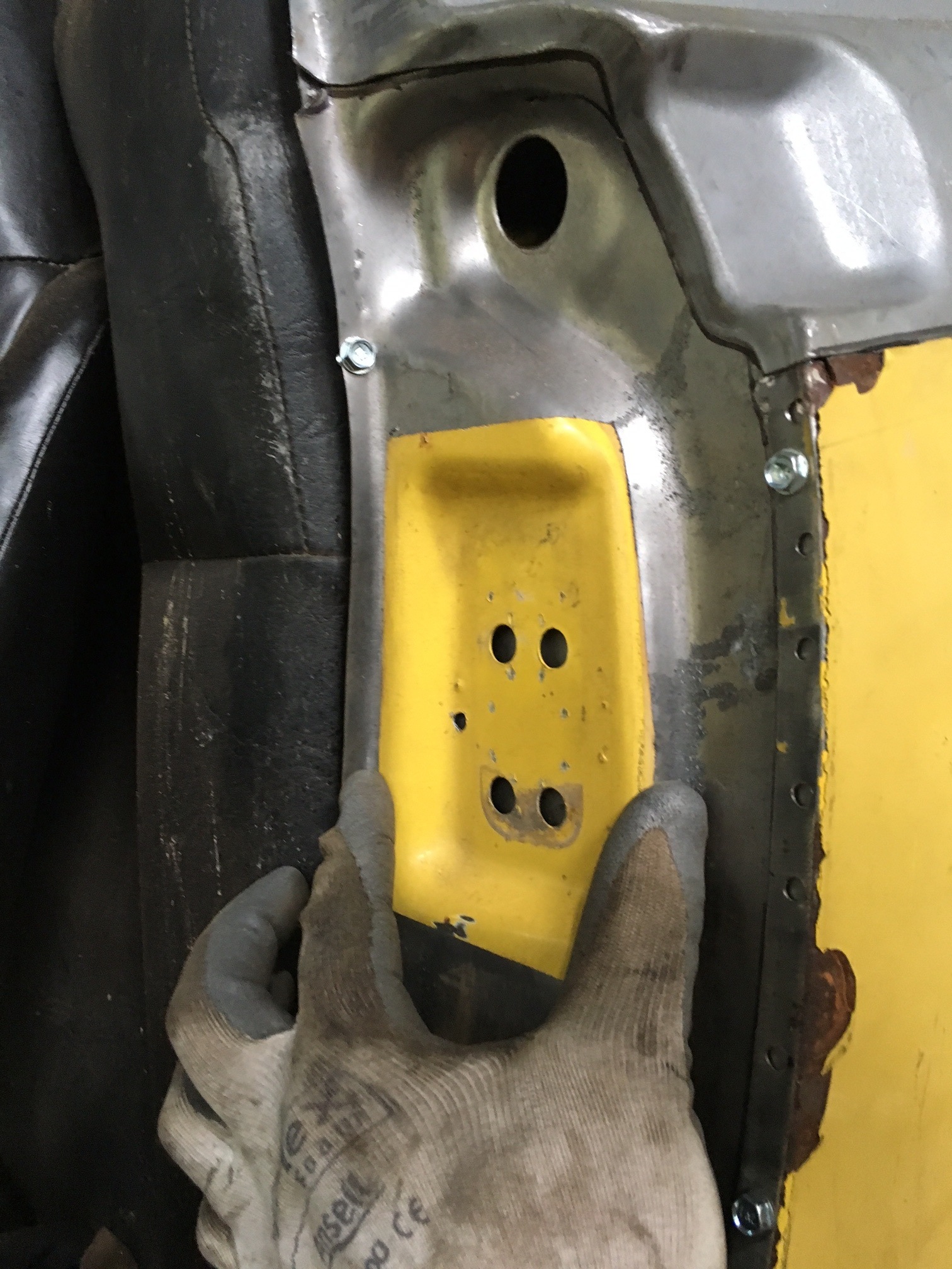

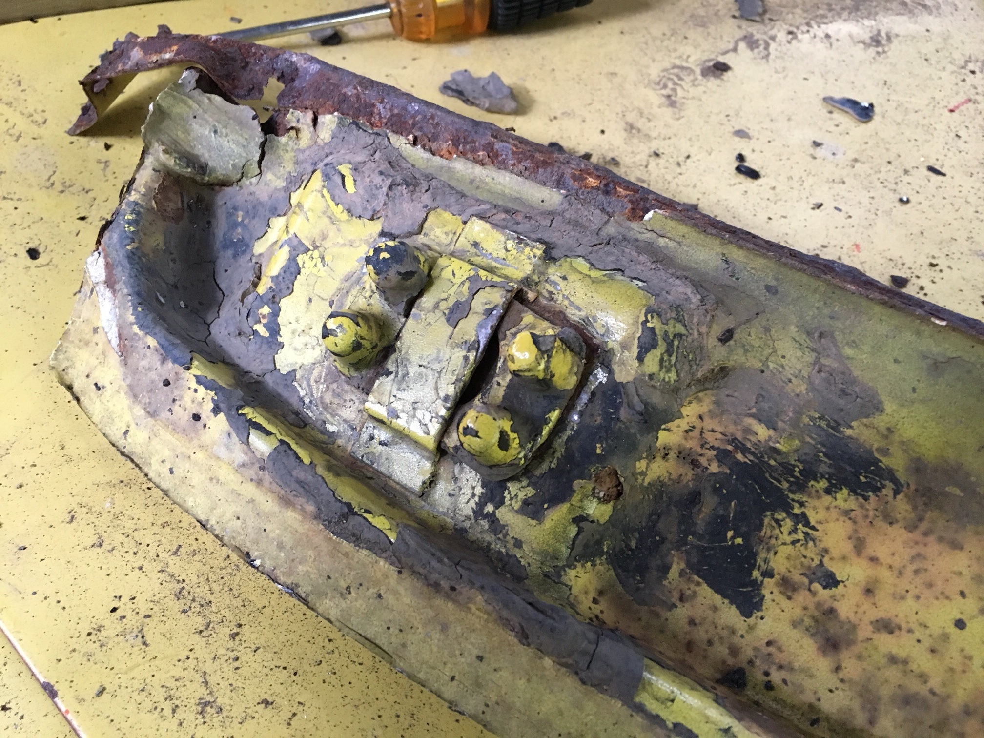

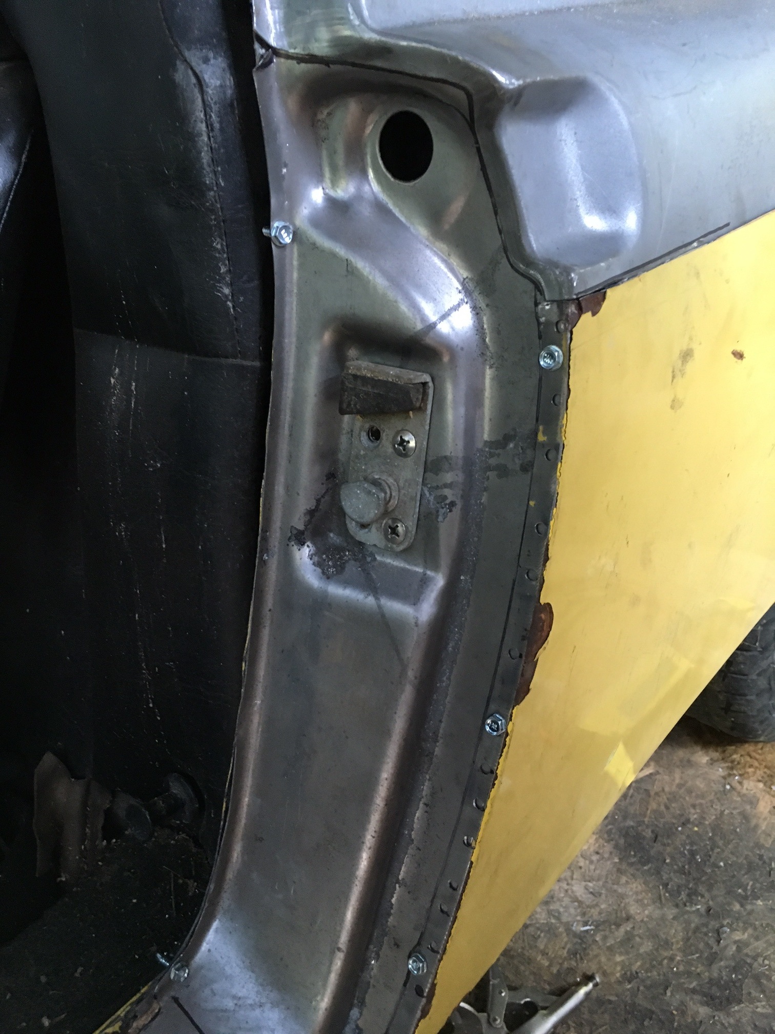

One of the tasks I had to do to the door jamb was to relocate the striker plate for the door. I drilled out the spot welds on the retaining strap on the back of the old jamb. I then used part of the old jamb to locate my holes. I then installed the striker and adjusted the door. Then welded on the retaining strap again.
Door gap is looking good. (IMG:style_emoticons/default/shades.gif)
