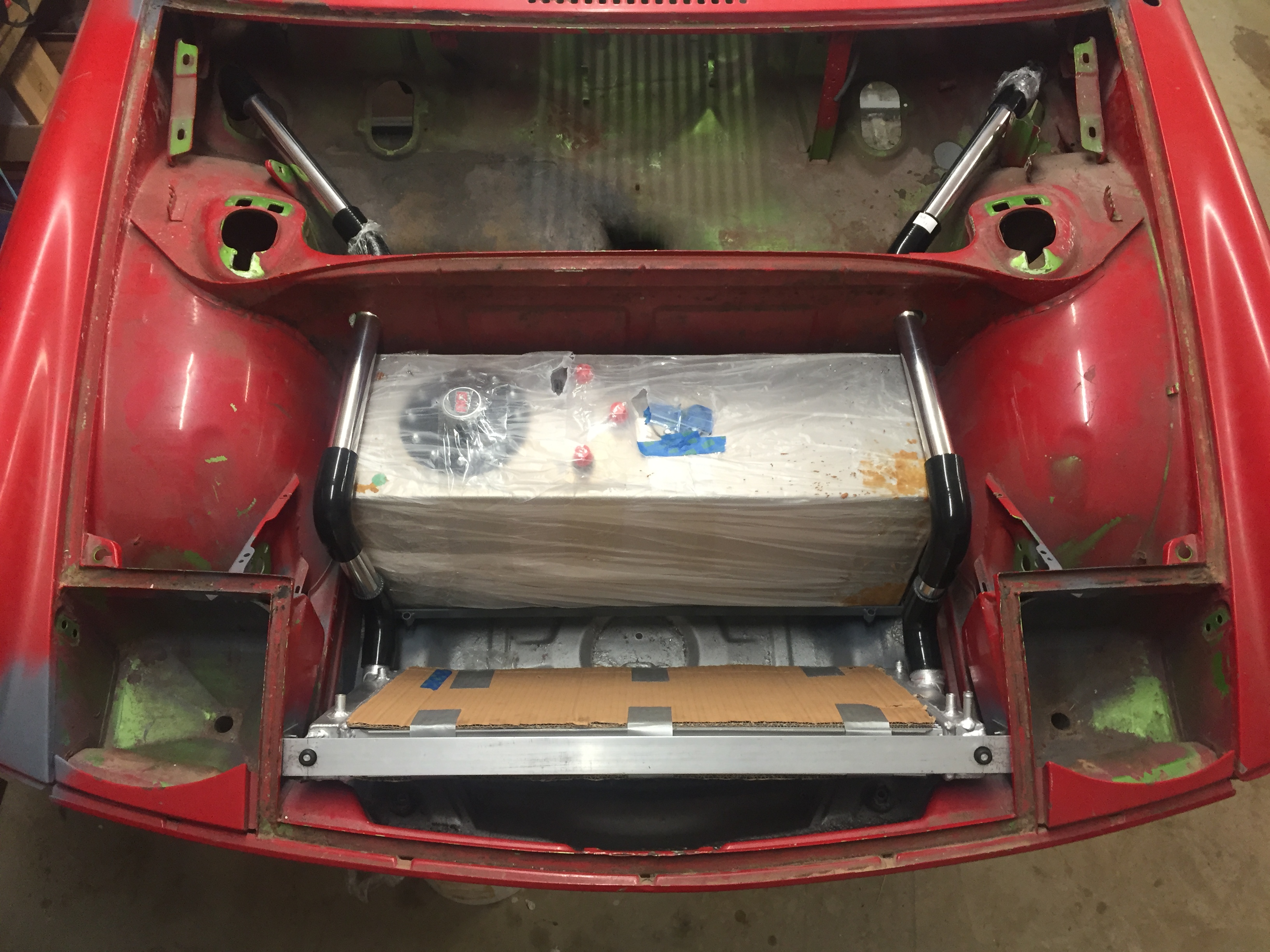

Got radiator mounted, fuel tank frame & removable mounting feet, as well as the start of the coolant pipes ... Also have been stripping down the wrx engine & replacing seals etc....

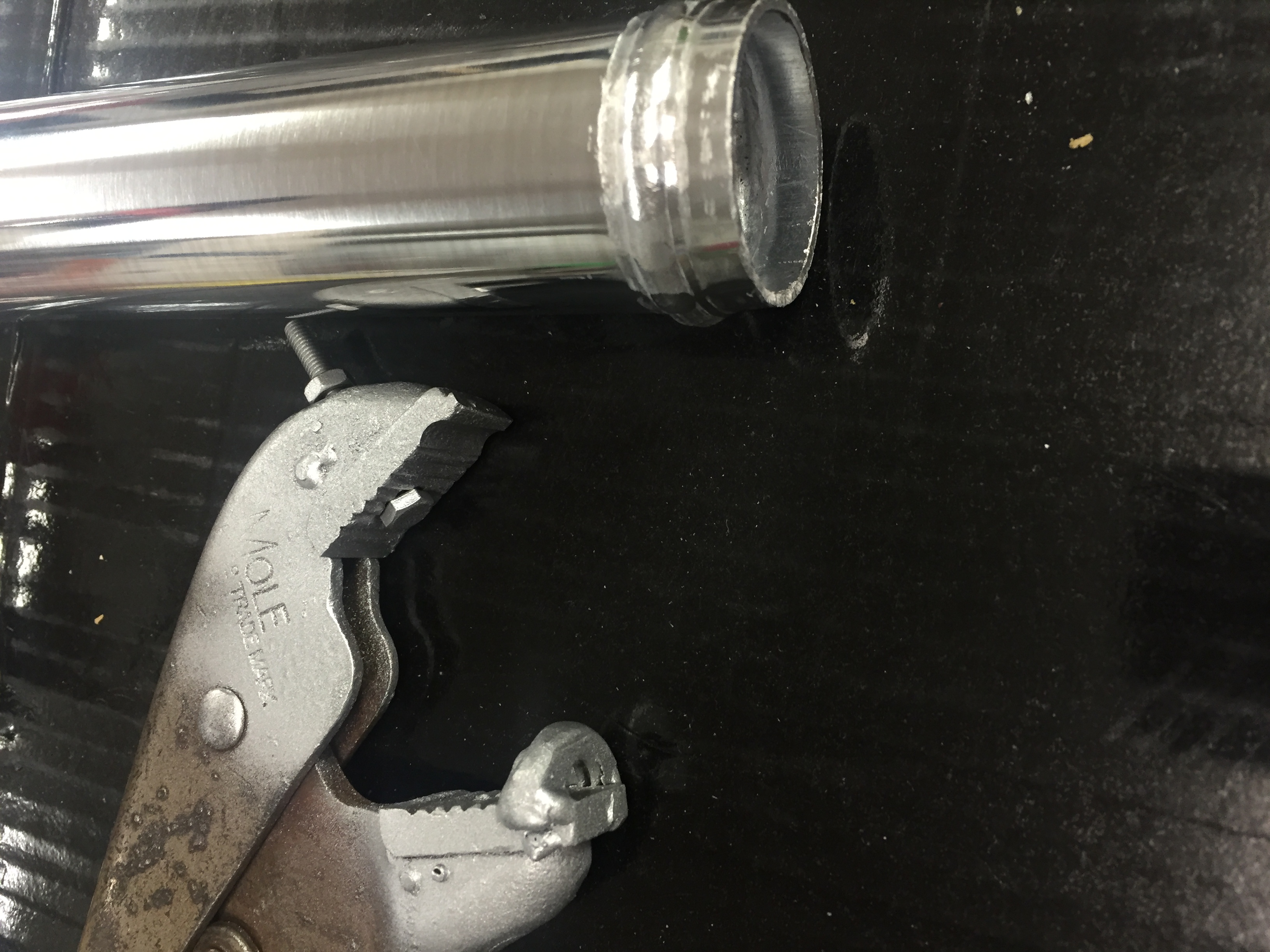

I also made up a tool for beading the aluminium coolant pipes ... Works well (IMG:style_emoticons/default/smile.gif)
