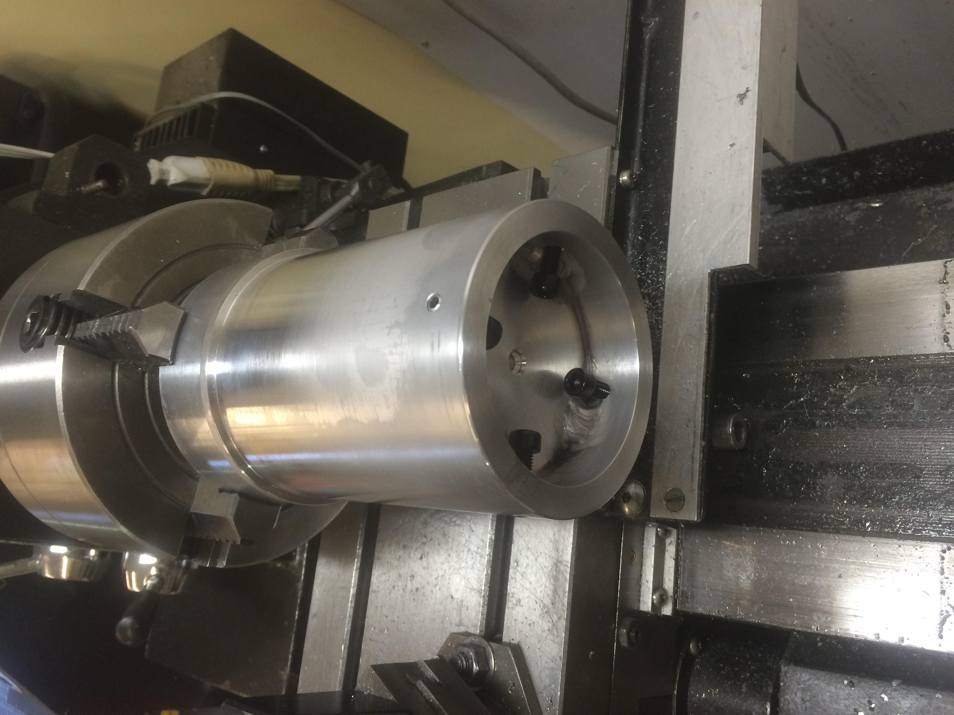

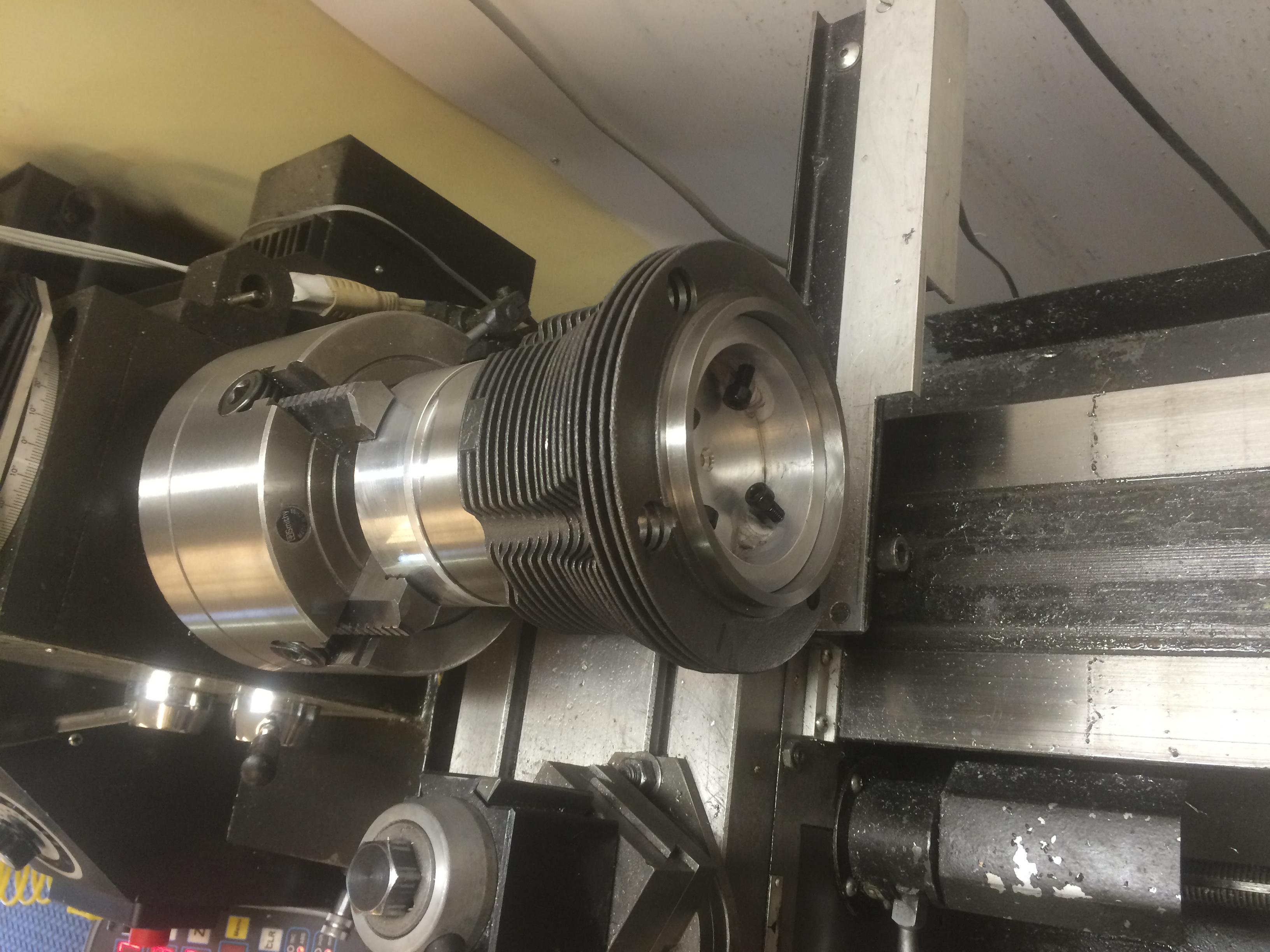

More progress. Have spent the better part of a week fabricating a fixture to take material (.72mm) off the top of the jugs in order to get the CR desired.
The jugs is very nearly an interference fit onto the fixture, and slides down to a shoulder to ensure all is true. Will use the tailstock on the lathe to make things even more secure/stabil when making the cut to the jugs. There are 4 aluminum set screws on the inside of the fixture to secure the jug. Is this overkill - YES. But all will be very true, and very much the same once completed.
