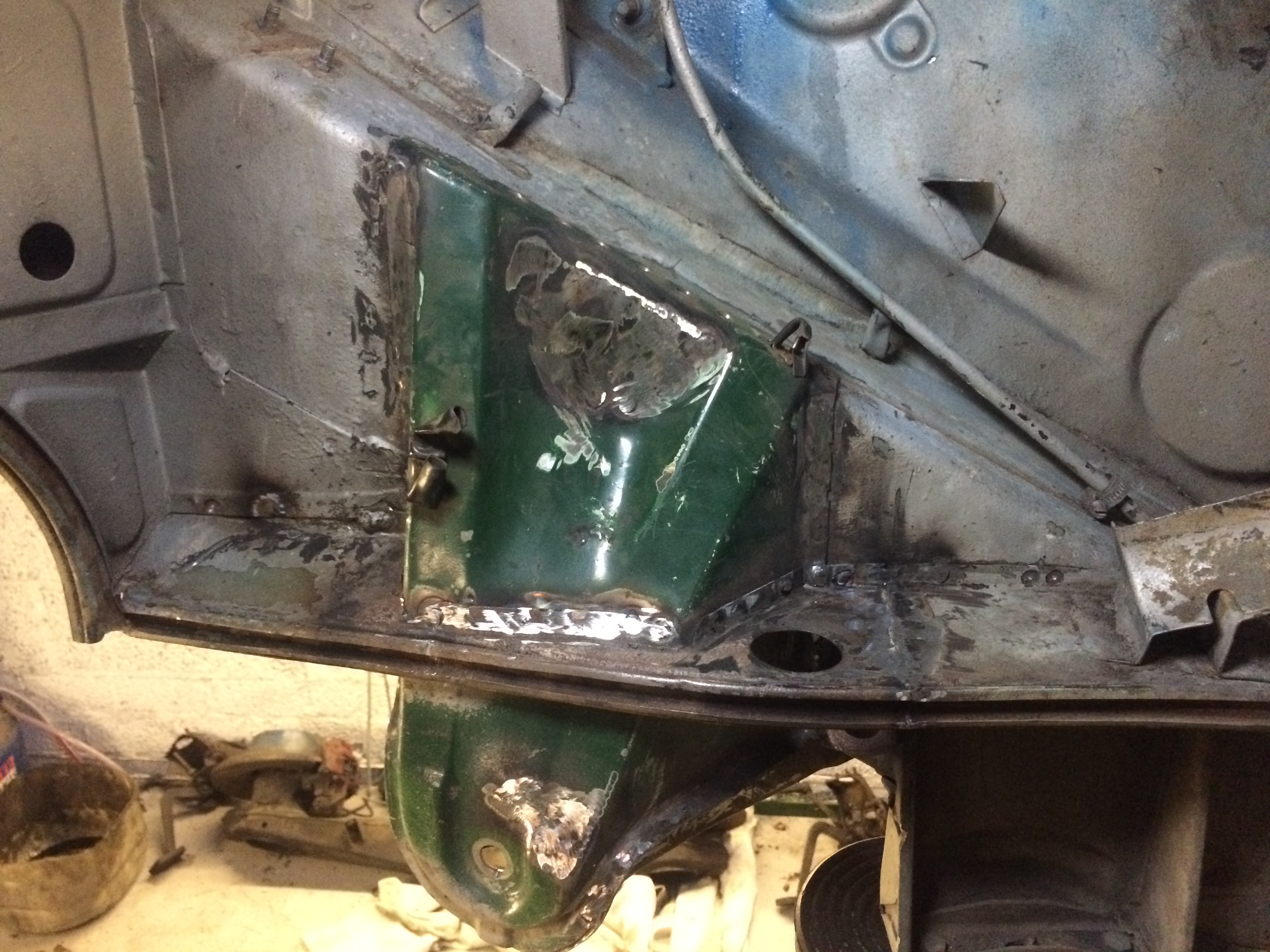

post Apr 30 2016, 04:07 AM
Posts: 139
Joined: 17-August 14
From: Uk Northern Ireland
Member No.: 17,784
A little more completed last night, engine shelf welded back in to position and the suspension console completed
