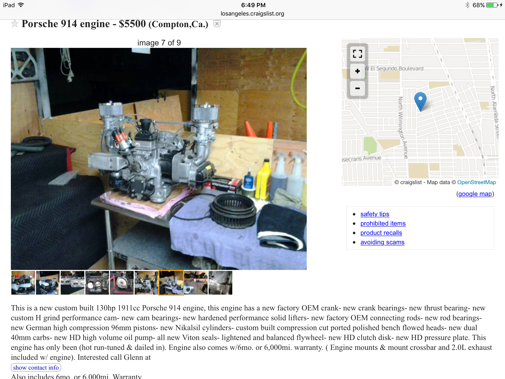

sixnotfour   $5500 new German high compression 96mm piston...   May 3 2016, 02:24 PM
ericoneal   Be sure to screenshot the Craigslist ad before it ...   May 3 2016, 02:53 PM
Porschef   :WTF: Maybe that's the engine that was suppo...   May 3 2016, 02:52 PM

'73-914kid   Those aren't nickies in the picture from the c...   May 3 2016, 06:10 PM
396   Not to beat this to death. But if that's what...   May 3 2016, 06:40 PM
Mueller   Not to beat this to death. But if that's wha...   May 3 2016, 07:04 PM
r_towle   Still would be aluminum.   May 3 2016, 07:04 PM
r_towle   While they certainly may exist, I have not seen ca...   May 3 2016, 07:06 PM
