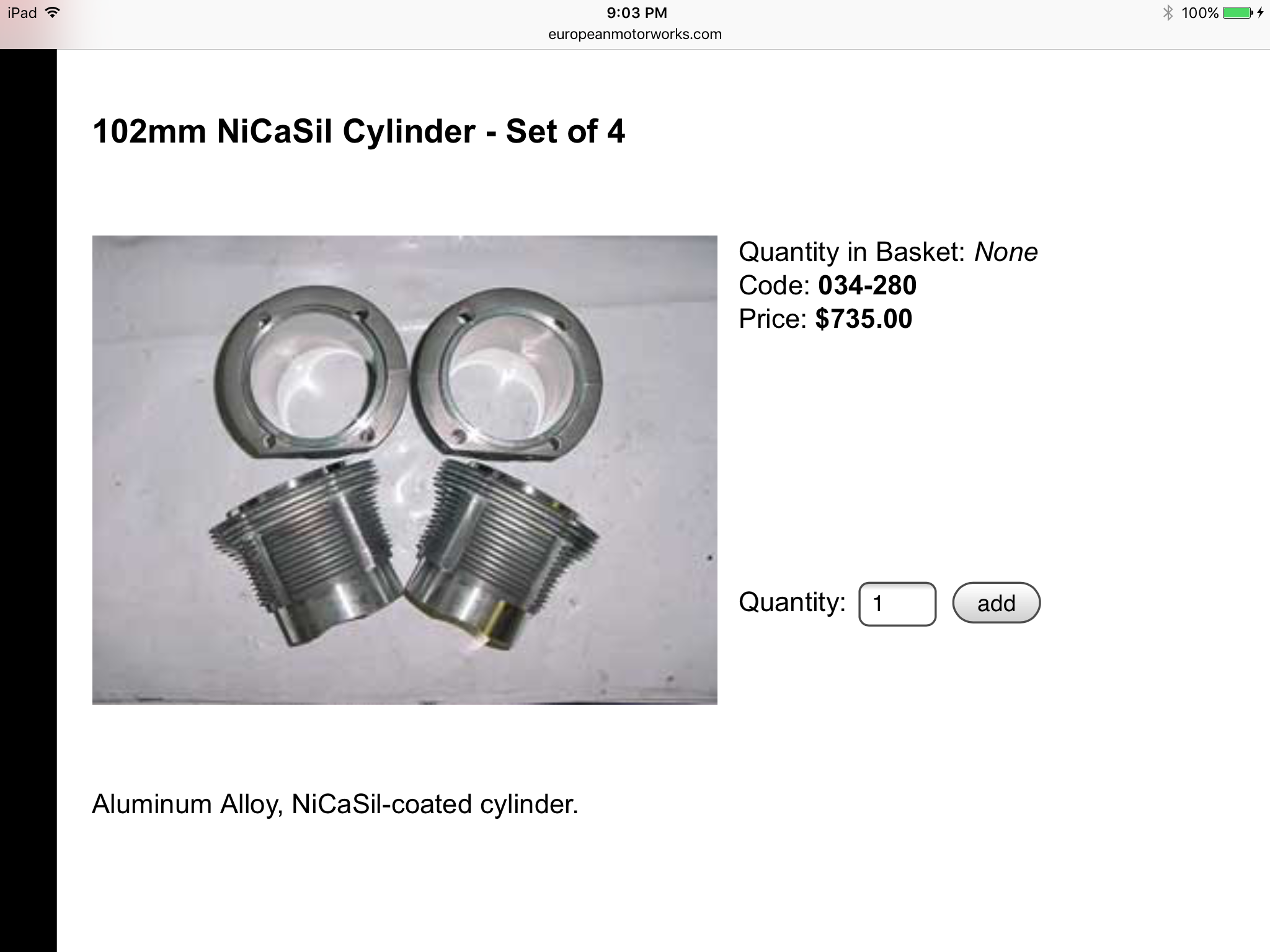

Still would be aluminum.

Hans Jan   Earlier this week there was some confusion about t...   May 4 2016, 05:24 PM
r_towle   Cool for that I guess. I have used 103 cast cylind...   May 4 2016, 05:53 PM
