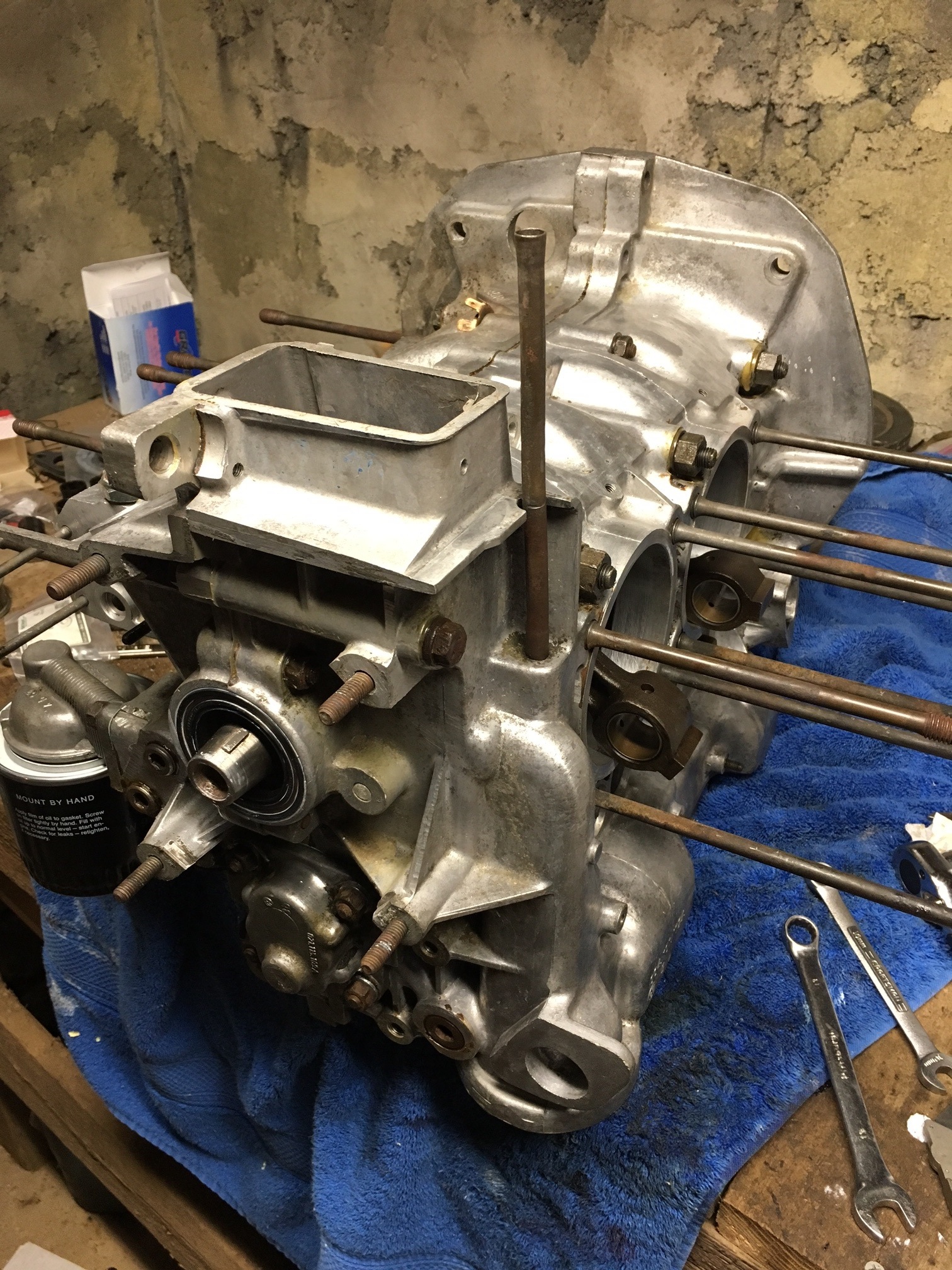

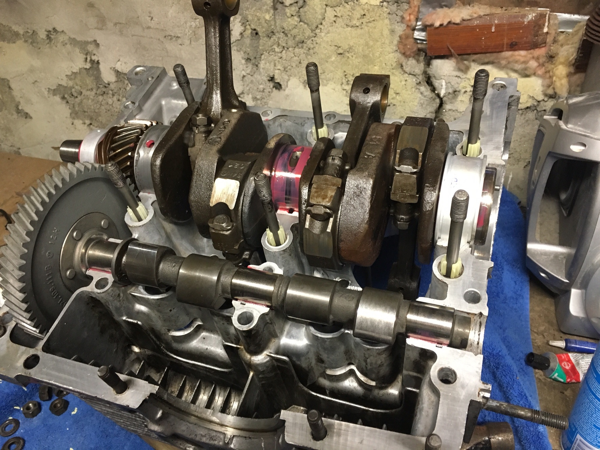

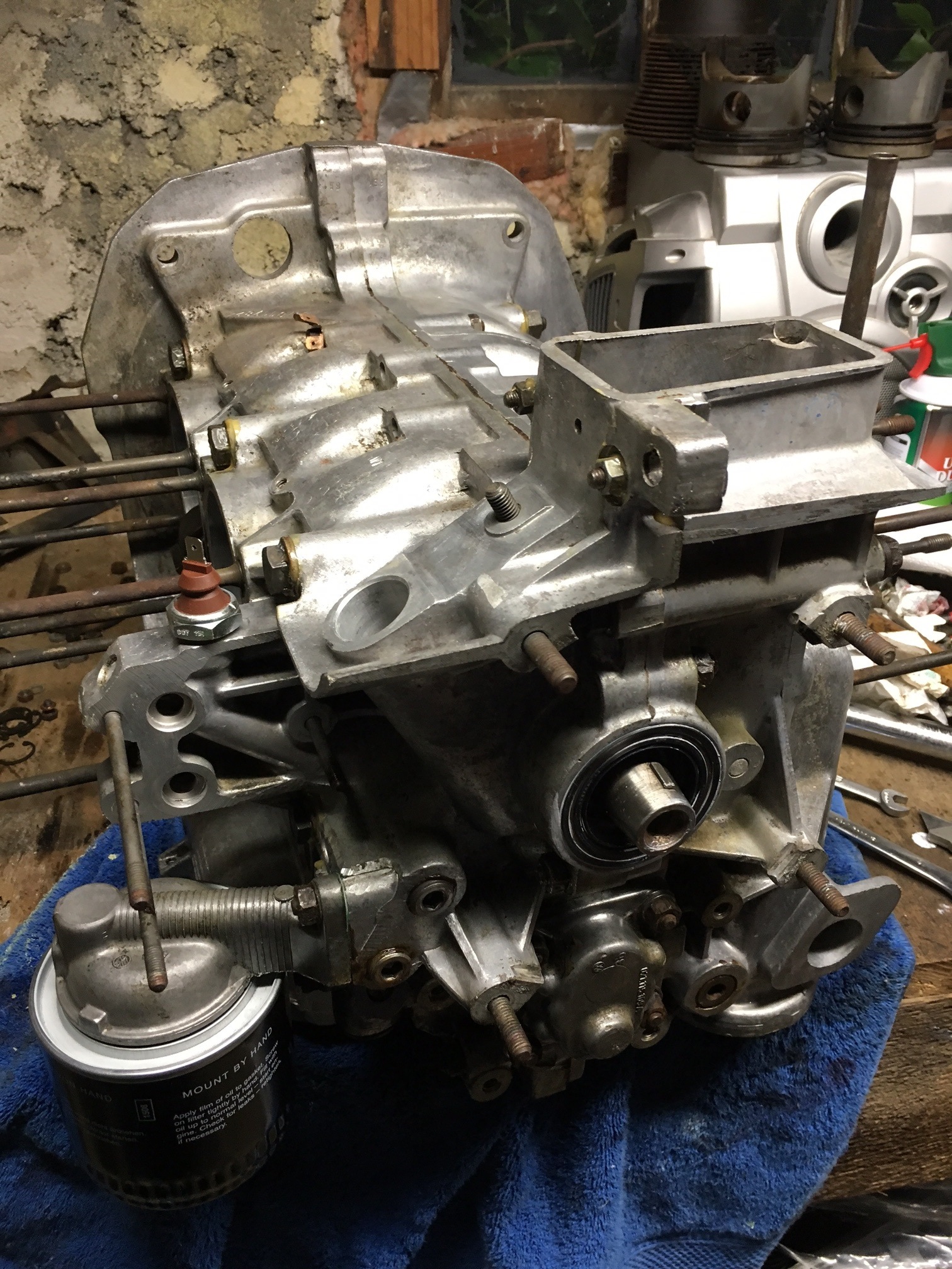

Progress: I got the engine halves back together and started putting some of the items back on it. (IMG:style_emoticons/default/smile.gif)
