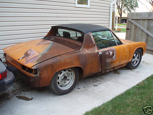

Maybe this poor guy still kept his cold start !

PancakePorsche   Maybe this poor guy still kept his cold start ...   May 7 2016, 02:03 AM
gereed75   There it is! I am guessing the micro switches ...   May 7 2016, 07:30 AM
PancakePorsche   Those switches are for MFI car (throttle position)...   May 7 2016, 12:50 PM
