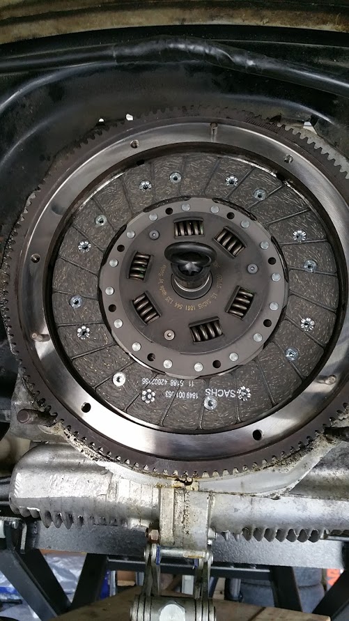

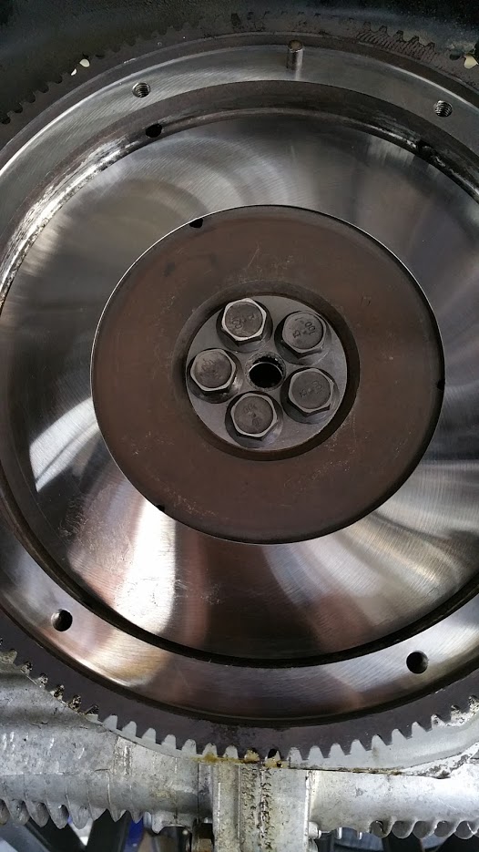

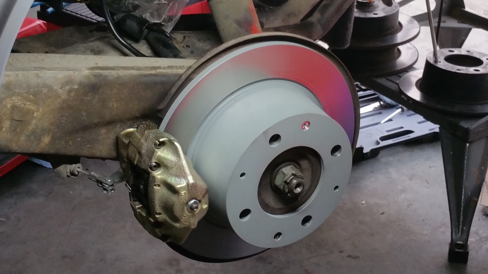

So I'm still waiting on a couple rubber boots to arrive to get this put back together. I did get the transmission reinstalled, and along with it a new clutch and pressure plate. The flywheel had enough meat left to do a resurface. I took 0.023" off, which I also ground from crown of the flywheel bolt heads. I also added a 0.023" washer under the pivot ball. So it should all work sweetly (crossing fingers.) I resealed the trans with all new seals. So while fiddling around with my brakes, I thought I'd mic my discs. Way past the wear limit. So not much choice, I ordered a set of discs and rebuild calipers from PMB. Didn't expect this bill, but all new brakes (and lines) will be really nice for staying alive. I also got my wheels painted up in the meantime and new tires mounted. These are Dunlop SP Sport 5000 195/65s. I'm having a little fun with this one, so I took an oil paint marker to paint the raised letters. If all goes well in the next week, I'll have this car back on the road lickety split.

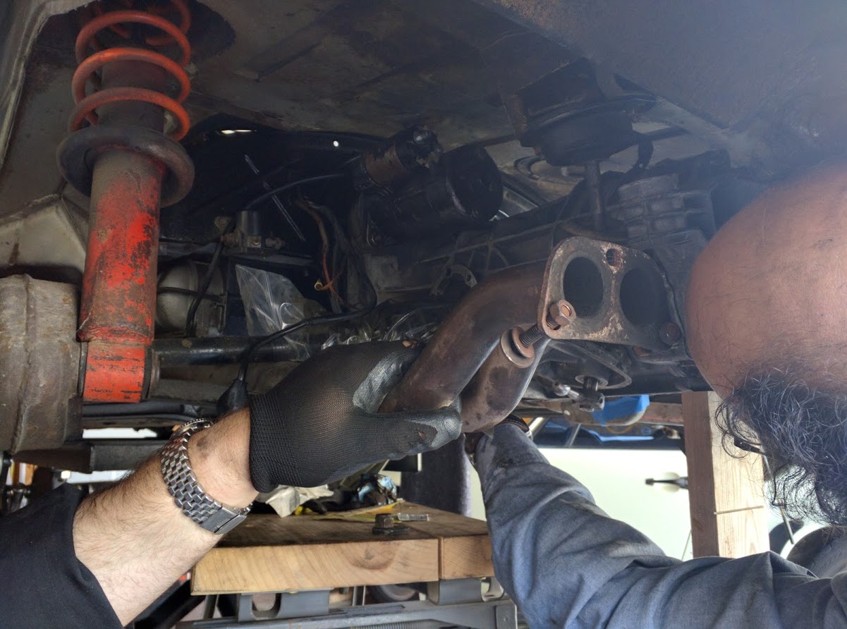

Jameel   Took the day off to work on this. I spent the last...   Mar 17 2016, 07:56 PM
Jameel   Next I loosened the connection between the two shi...   Mar 17 2016, 08:08 PM
Jameel   Next I began removing the engine support bar to re...   Mar 17 2016, 08:26 PM

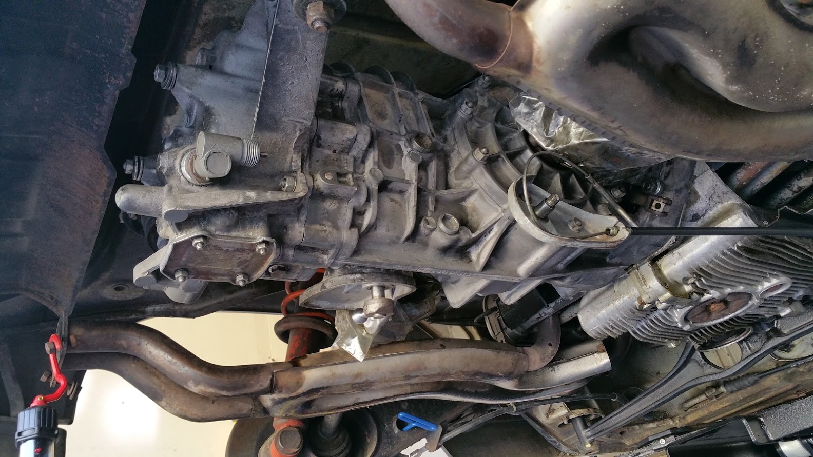

Jameel   Had an hour today to fiddle with this. First up, I...   Mar 21 2016, 09:36 PM
Jameel   Moving along....I removed the side cover plate whi...   Mar 26 2016, 08:44 AM

Jameel   Dropped my flywheel off this morning, got it back ...   Mar 29 2016, 09:46 PM
mepstein   I just resurfaced mine for my six conversion. For ...   Mar 29 2016, 09:57 PM
Dr Evil   Things to consider: 1) Was the flywheel finished t...   Mar 29 2016, 10:41 PM
