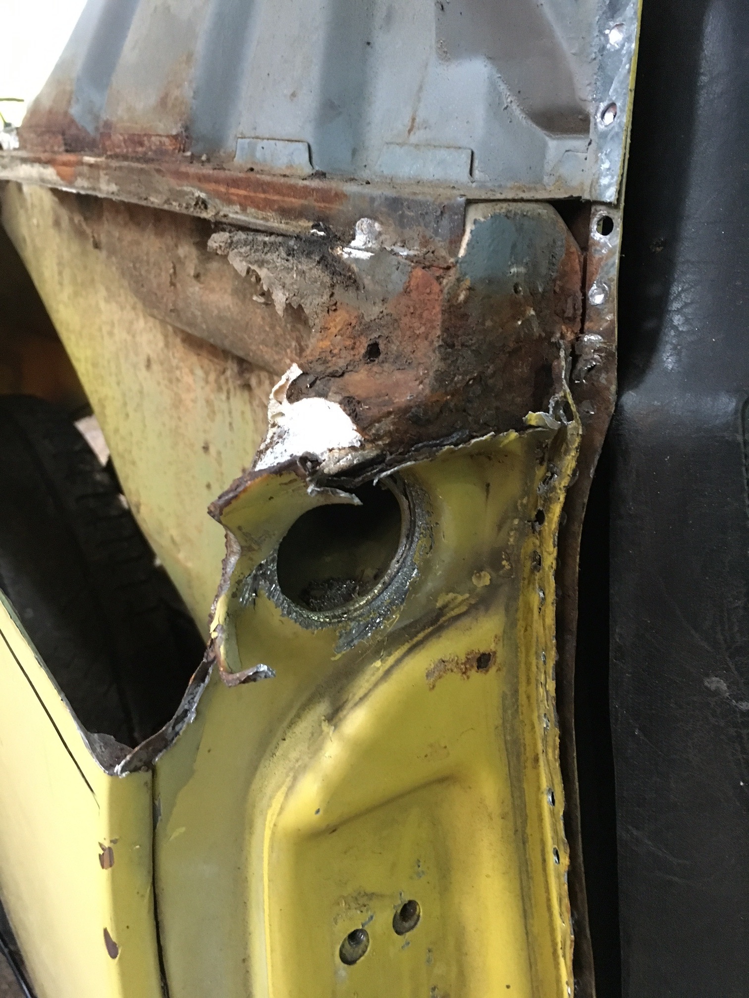

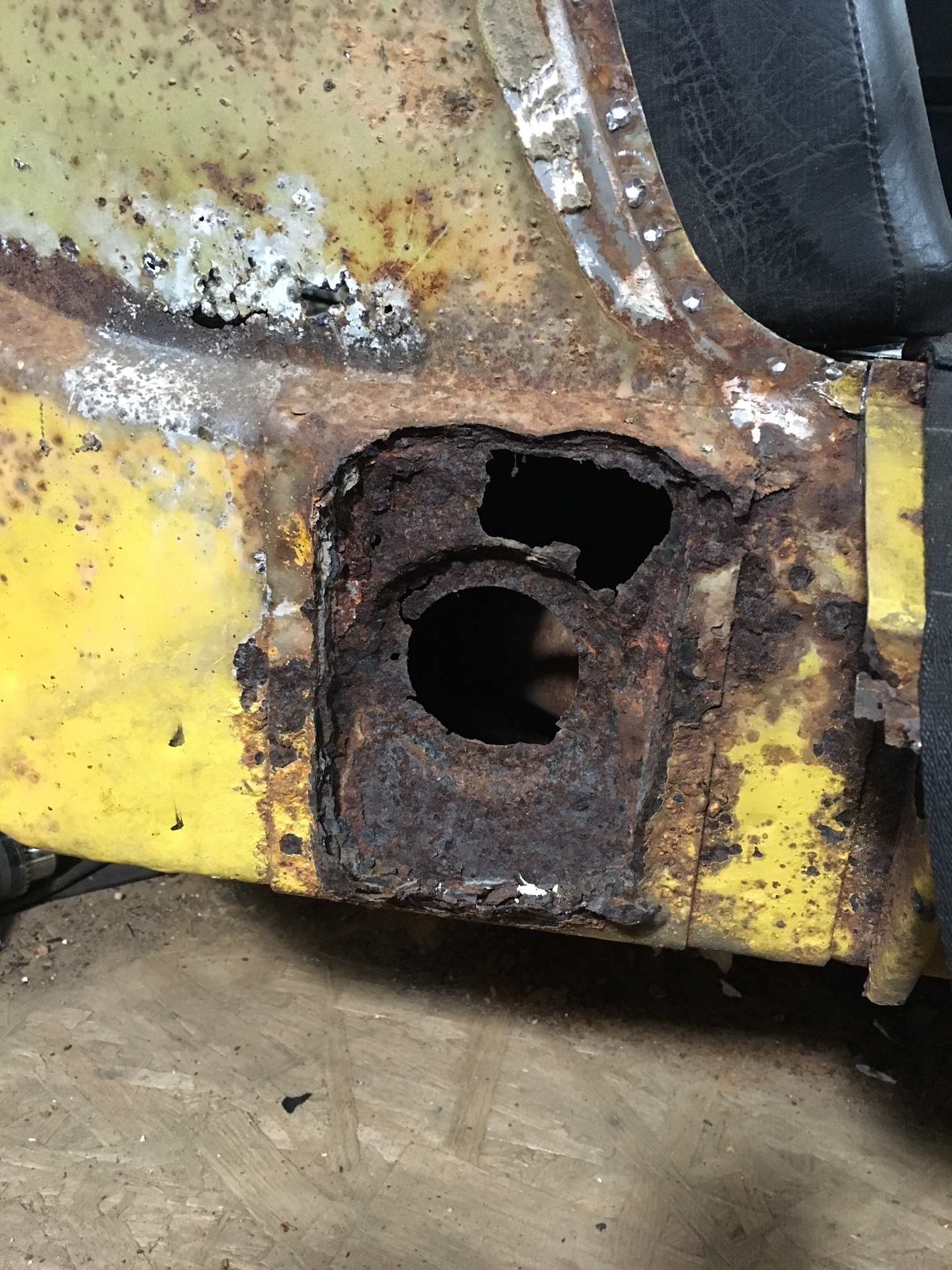

The infamous glob of goo that causes so much rust.
The jackpoint. I'm going to have to dig a little deeper than I thought in this area but its still very manageable. The inside long will need a small patch and I'll replace the outer completely.
