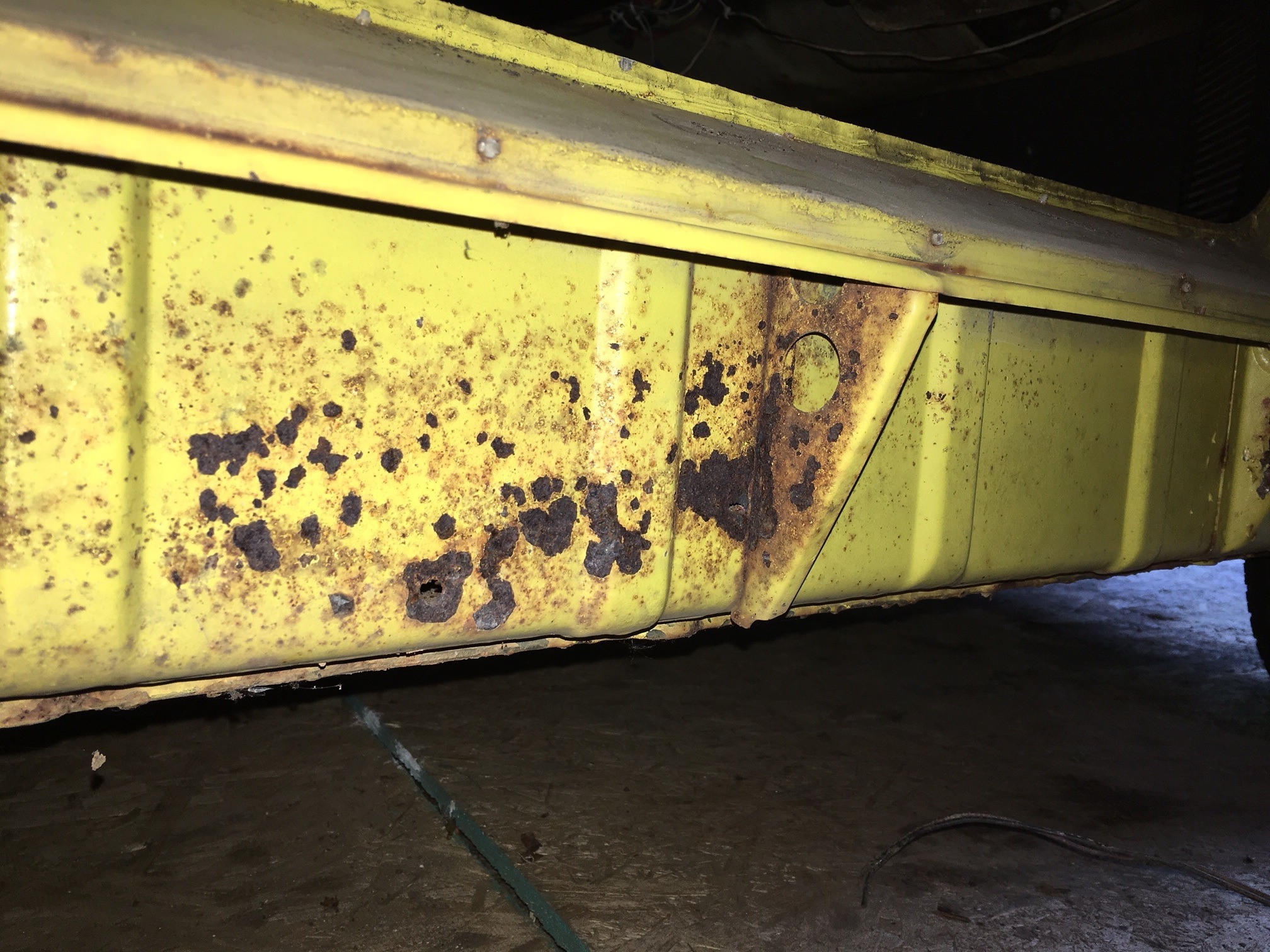

The battery tray has some light surface rust
Here's the underside of the passenger long. I was able to jack the car up and door gaps didn't change (IMG:style_emoticons/default/piratenanner.gif) .... Heck, most 914s I bring home don't even have a place to jack it up anymore.

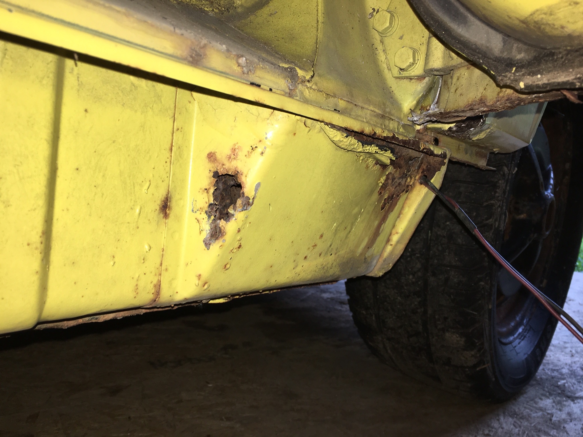

While I was in the area I took a good look at the rest of the long it has rust coming through in a few odd places. I decided to go ahead and replace the whole long. Gotta place an order with restoration design.
