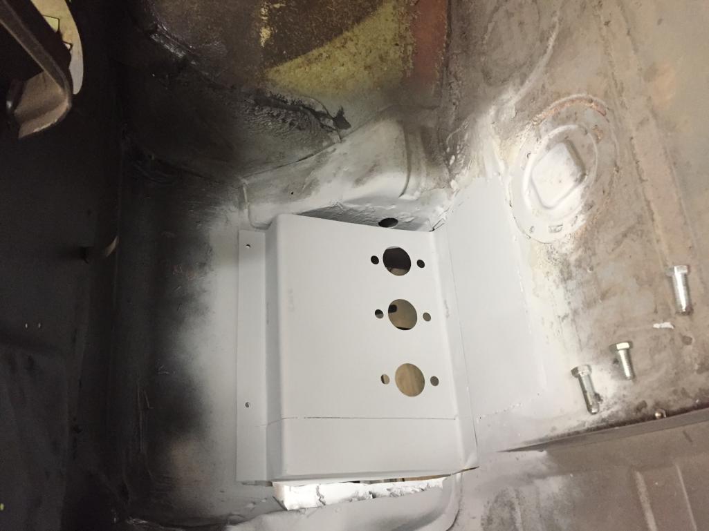

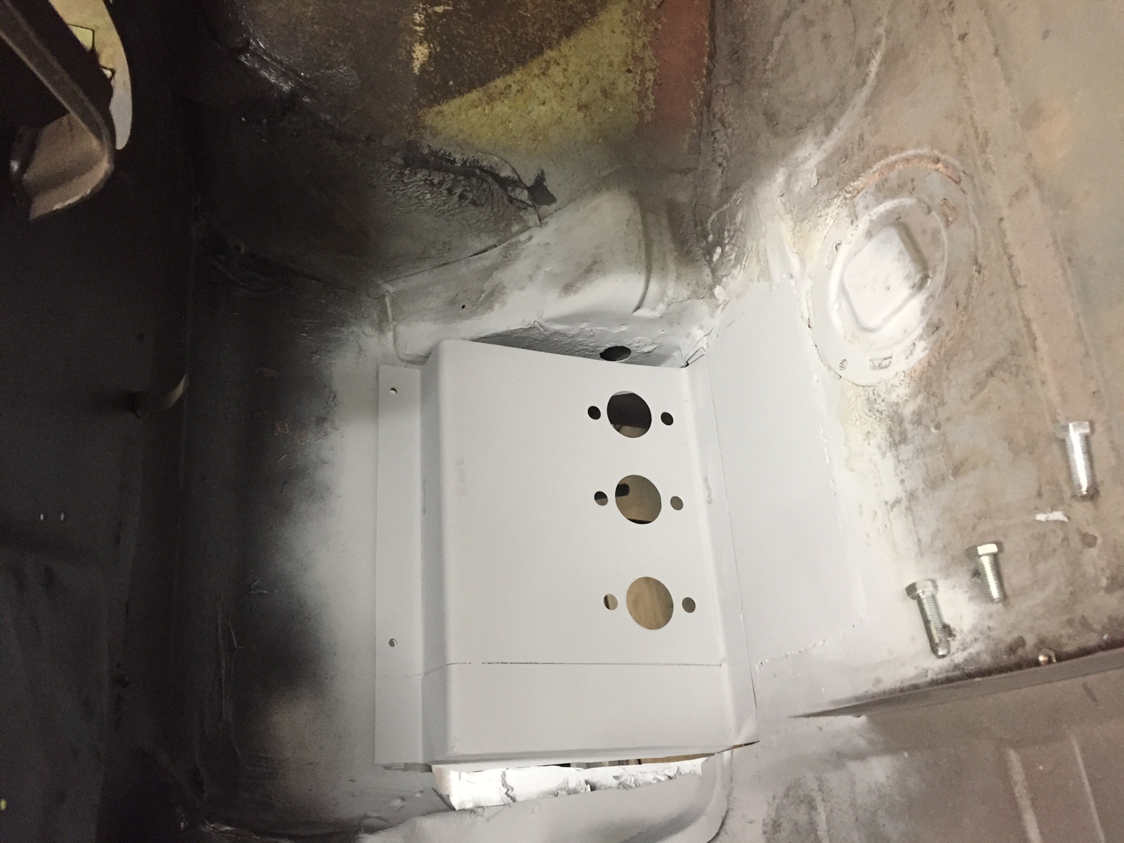

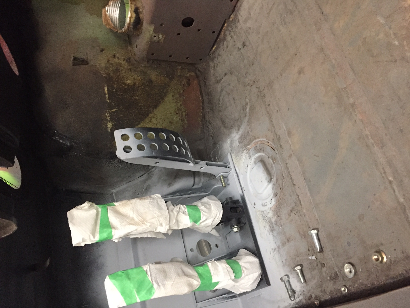

took a cut off wheel to the pedal box area & made up a new box for the 3 pedal assembly - its not completely done, but I have an off road adventure through western Australia to go on soon so just covered it up in primer while i'm away.
the new pedal assembly had to be cut up a bit and I had to make up a new accelerator pedal & associated brackets / levers for the cable - took a day, well, 8am to 3pm to sort out the pedal ratio's & brackets etc ...
the new pedal doesn't have the capability for a brake bias adjuster cable to run through it - the old one had a big U shape in the pedal to accommodate it. instead i'll use a 90 degree gearbox on the end of the bias bar.
i'm using wildwood master cylinders, of the 'compact' variety - they give me about an inch of clearance from the steering arm flexi joint.
I still have to work on the cross bar strap, but have a cunning plan that will leave it in place and provide some additional rigidity to the pedal box area.

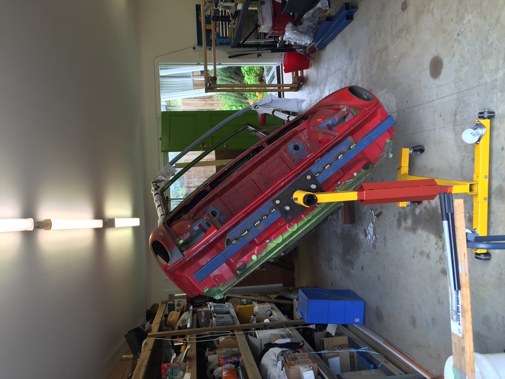

had to get the shell on the rotisserie in order to do all this too ... (IMG:style_emoticons/default/smile.gif)
