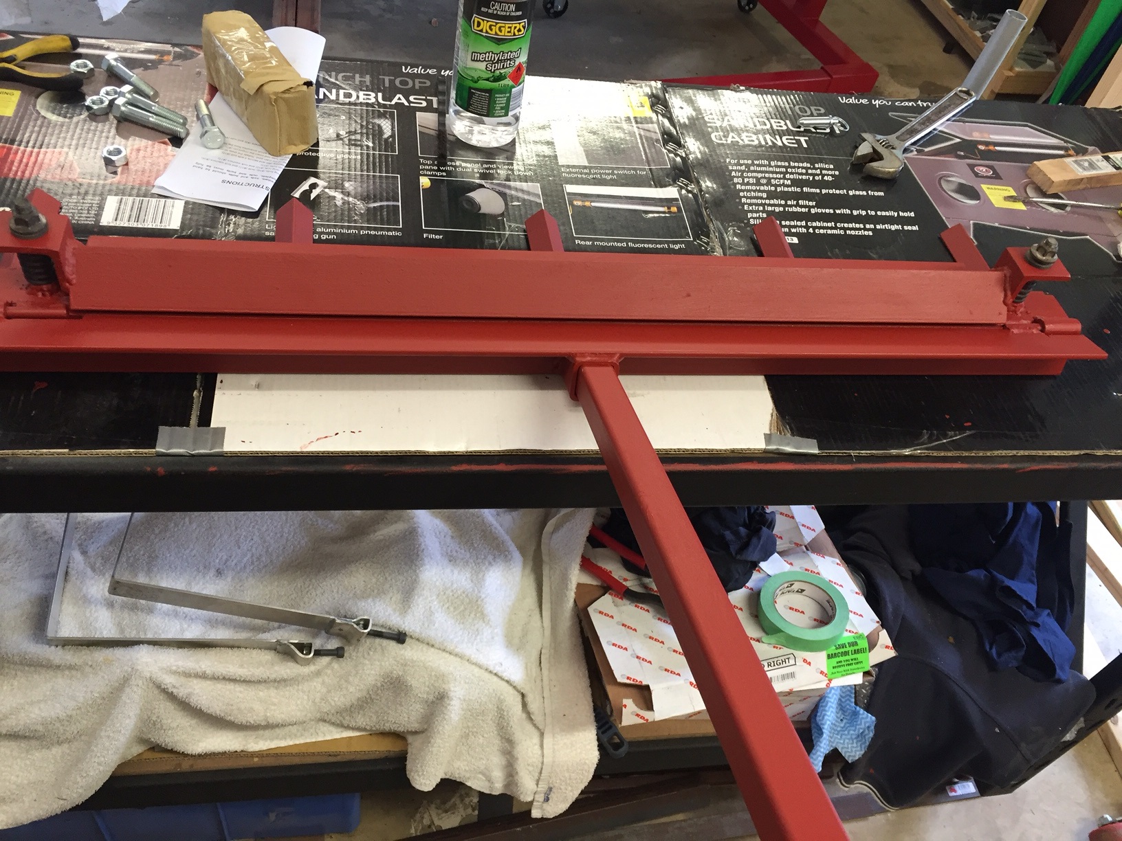

I had to bend some sheet metal for the pedal box - so made a metal brake ... works perfectly !
