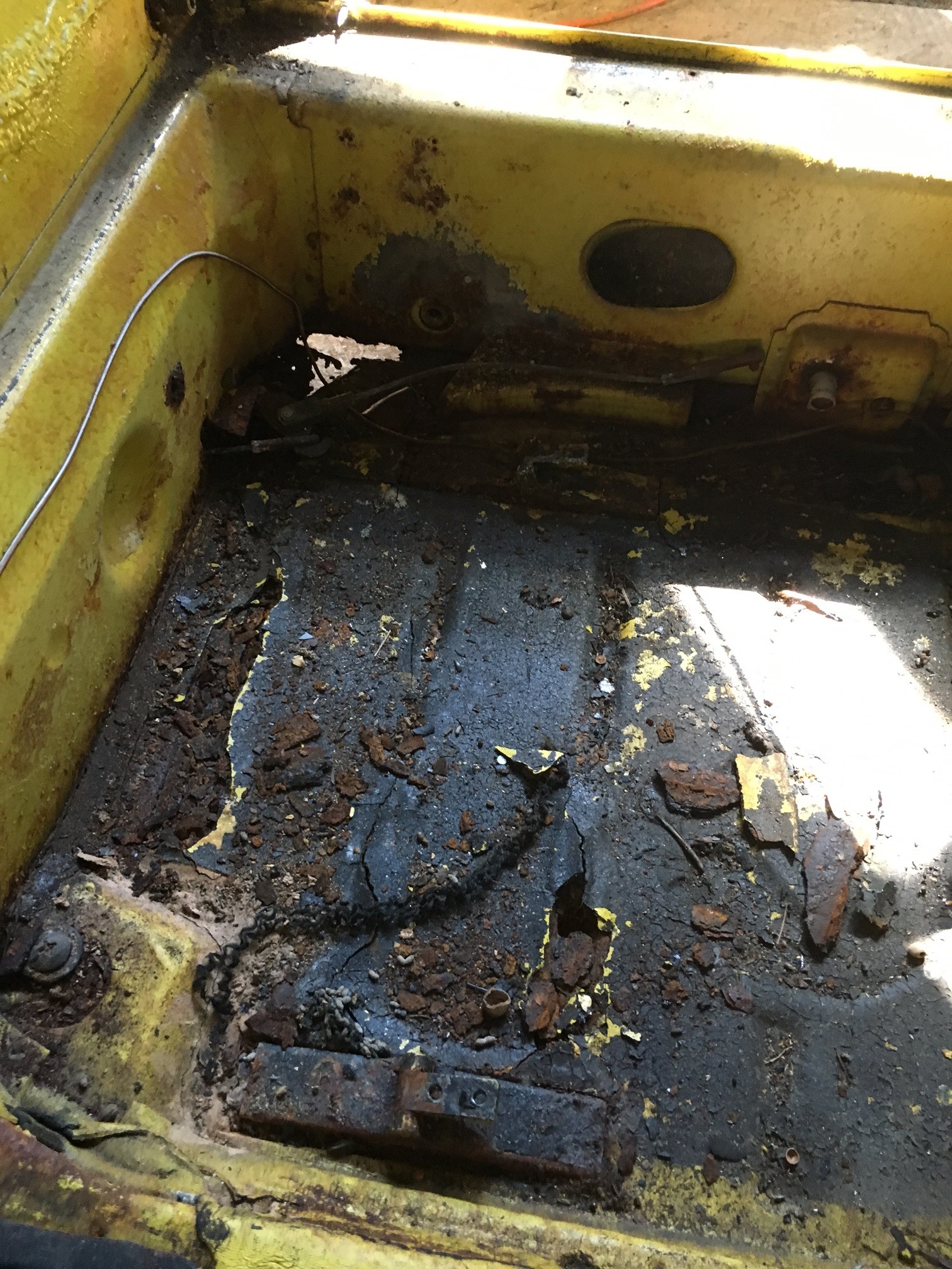

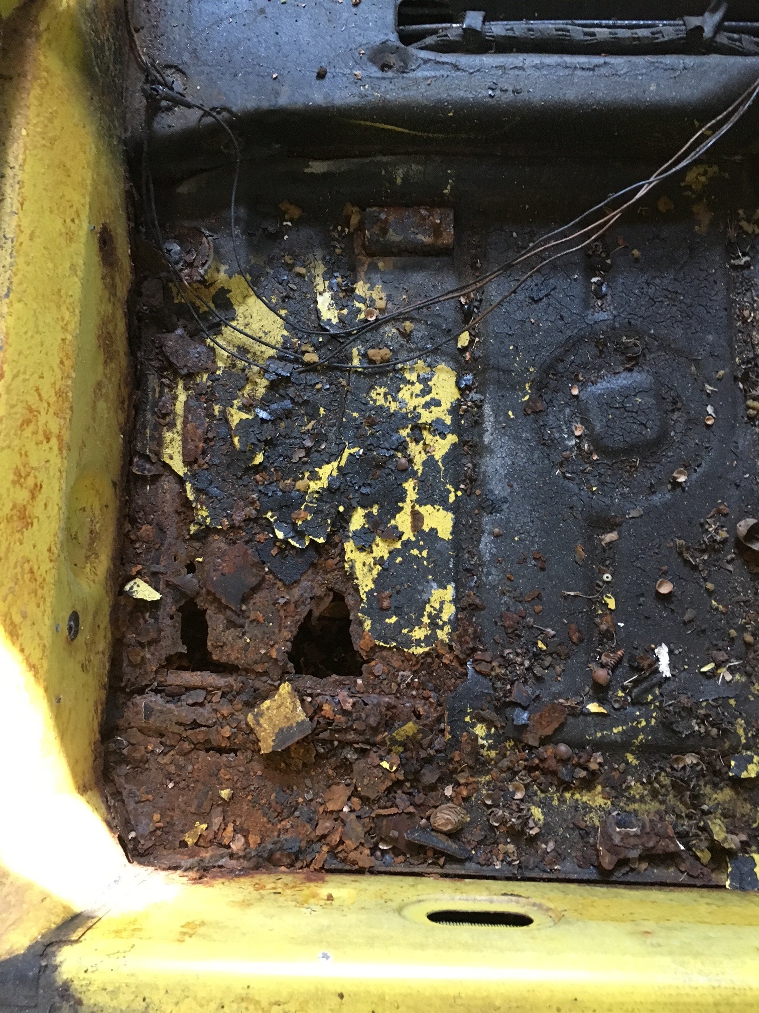

Today I took some time to remove the interior.
Good news: Interior is in good shape with no rips or tears. Just needs some cleaning. I also found $0.29. Score! Carpet is trashed but I already have replacements from 914Rubber.
Bad news: More rust. (IMG:style_emoticons/default/dry.gif) I had planned to replace the rear floorpan but now it looks like I will be replacing the inner lower firewall and possibly the floor crossmembers.
