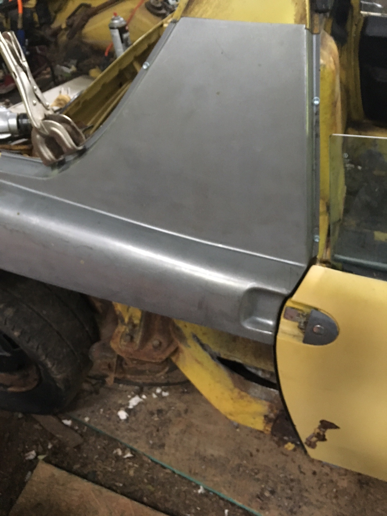

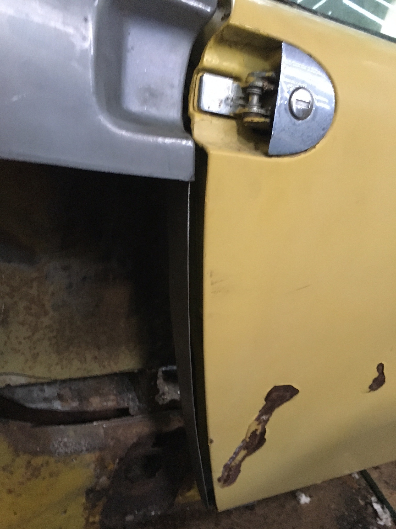

Got a little more work done tonight. I got the sail panel trimmed out as well as the door jamb for the passenger side. I'm fitting up the sail panel and fender first so going forward when I work on the inner rocker, I will have a good reference point to go by, the door gap.
