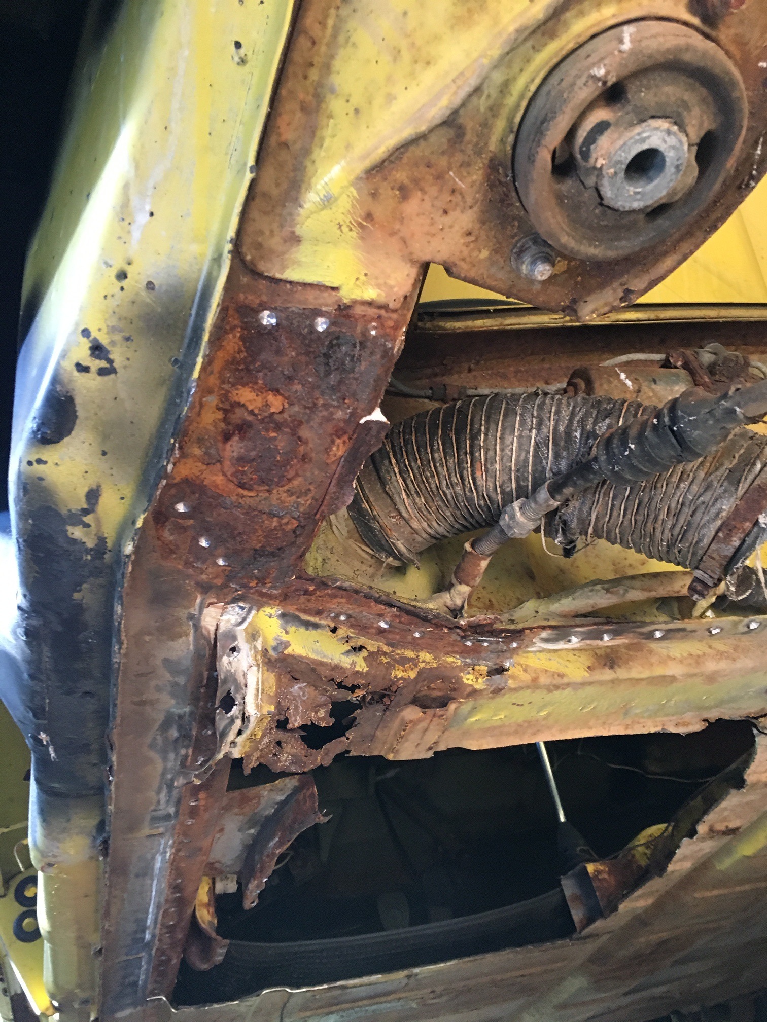

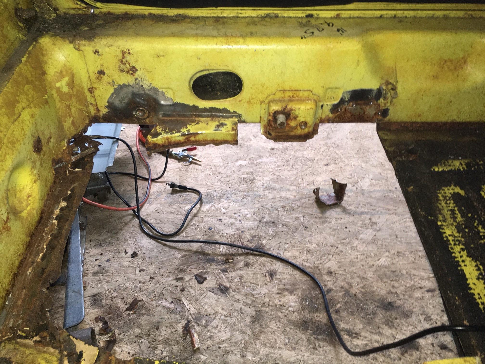

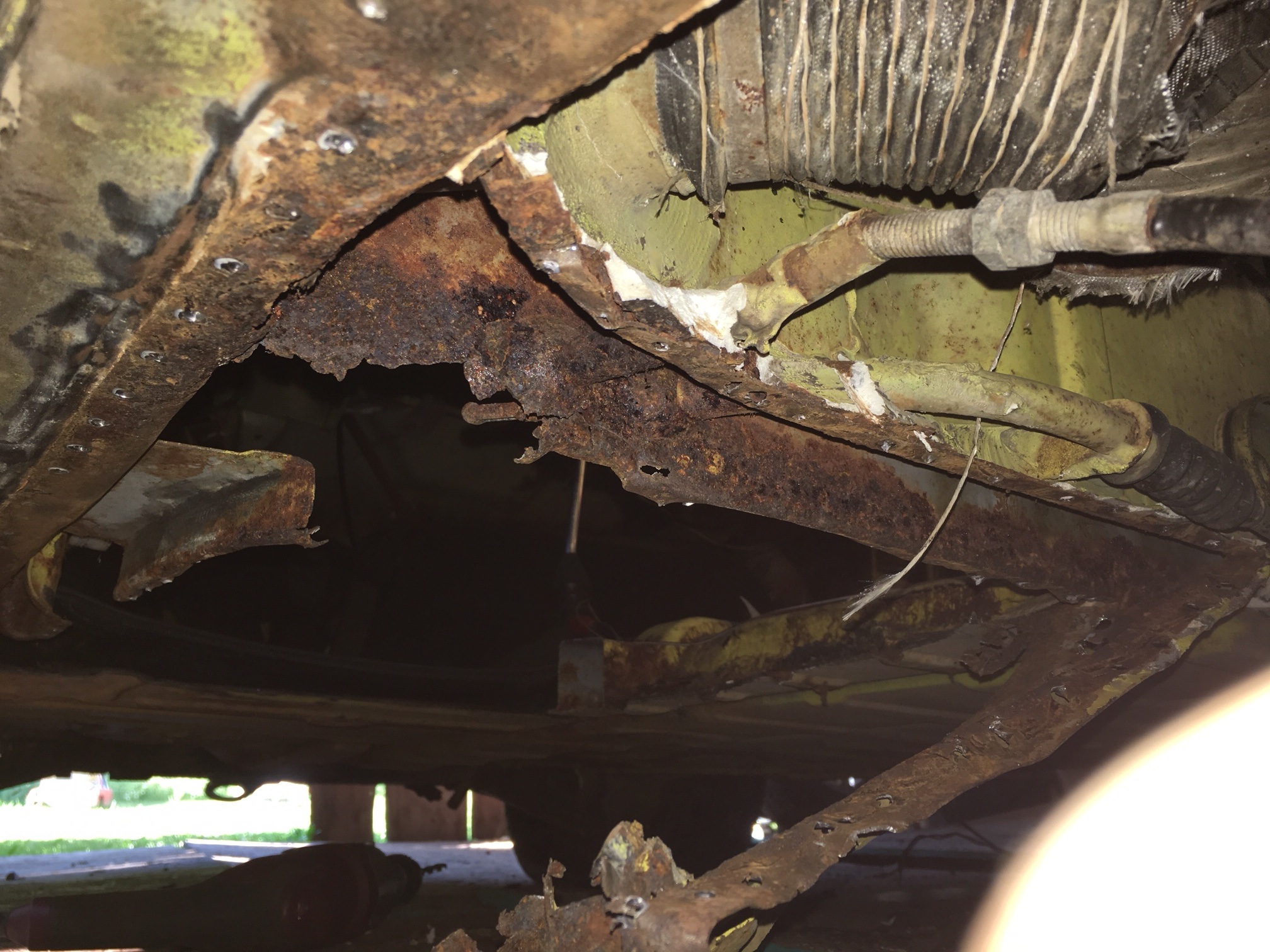

I started to tear out the floor. I'm about half way through. Its been a really fun time drilling out all the spot welds from underneath but so far so good.
Jacking triangle removed. Long is solid.
You can see the area of the inner firewall that will need some work on the drivers side.
