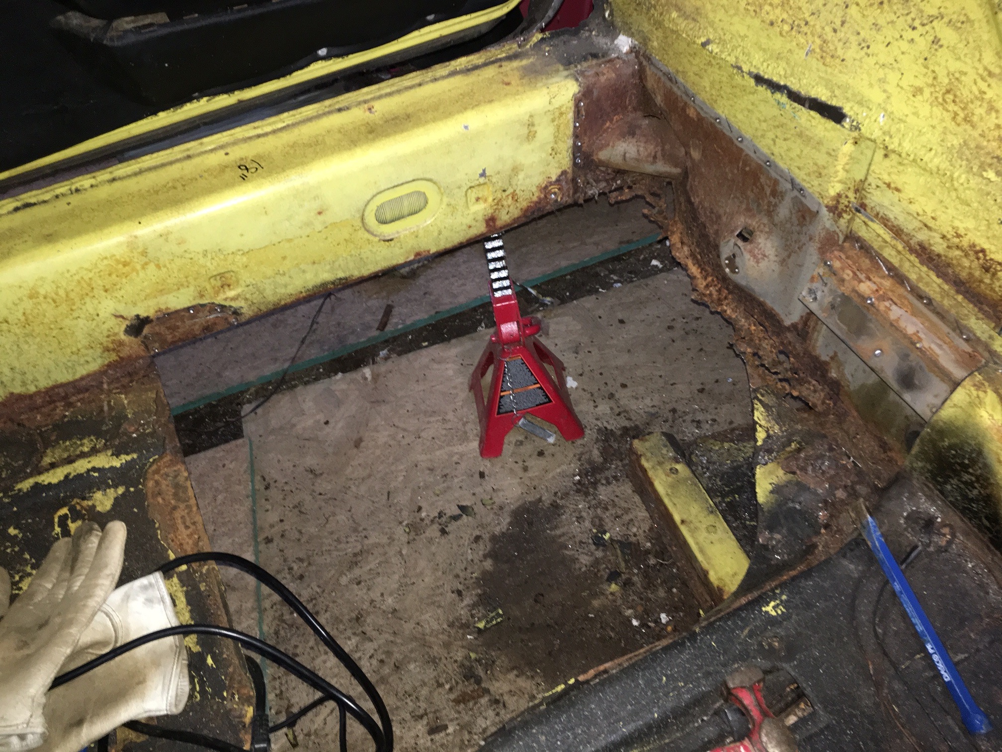

The battery tray has some light surface rust
Here's the underside of the passenger long. I was able to jack the car up and door gaps didn't change (IMG:style_emoticons/default/piratenanner.gif) .... Heck, most 914s I bring home don't even have a place to jack it up anymore.

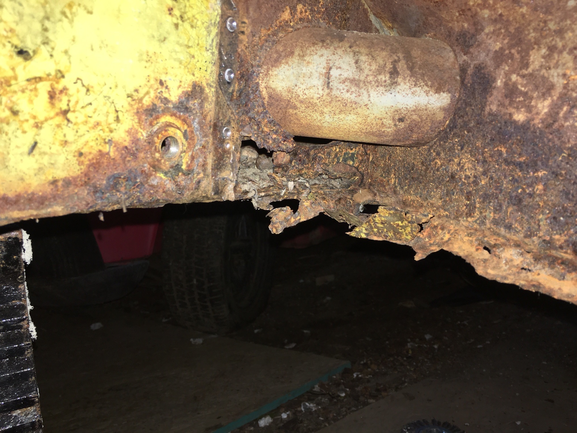

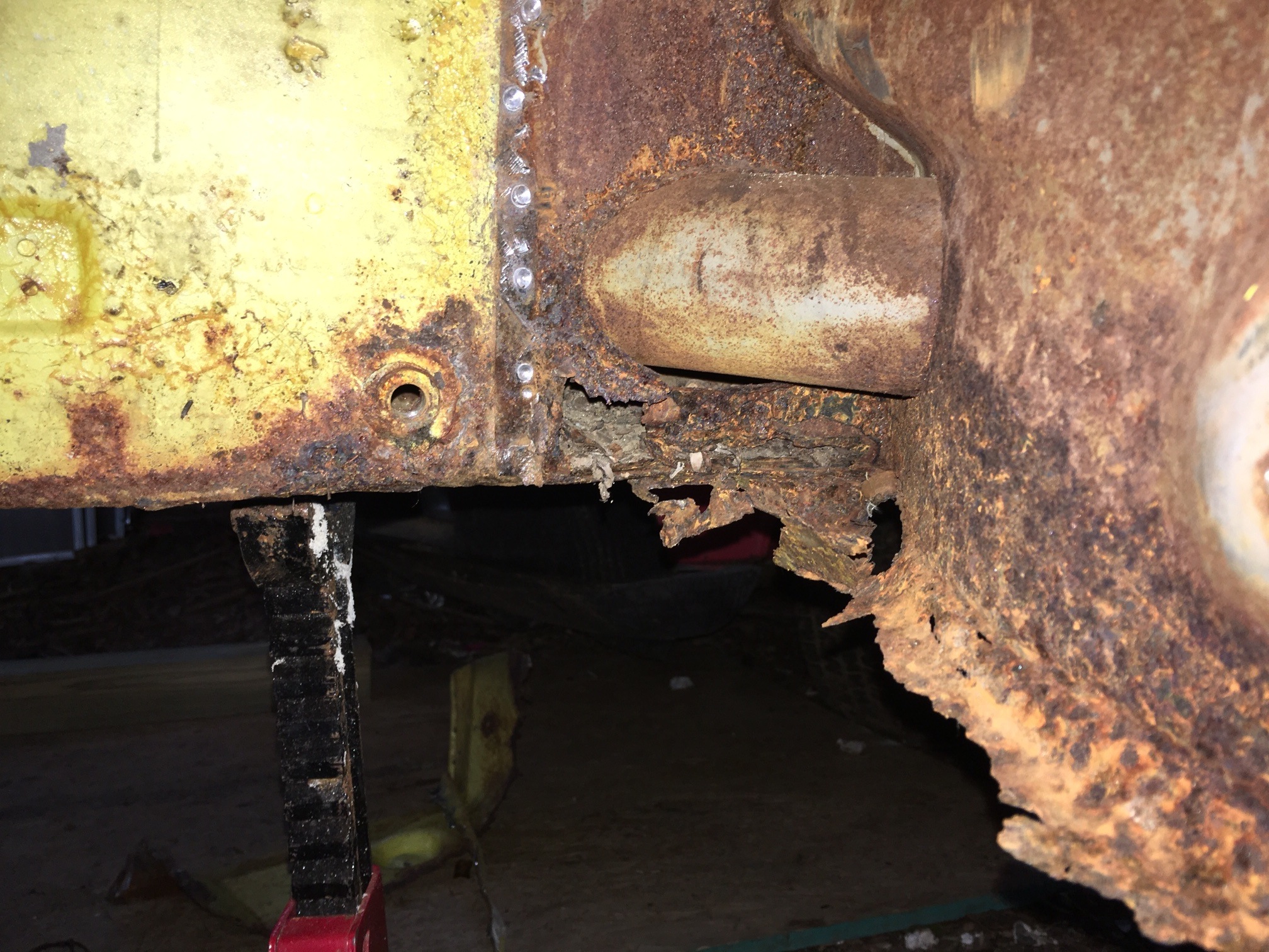

Got some more removed tonight. Crossmember is removed and passenger side inner firewall. I have a some more spot welds to drill out for the floor under the center tunnel and the floor will be completely removed
Inner Firewall removed.
And the only repair to the inner long I will have to do.... I hope.
