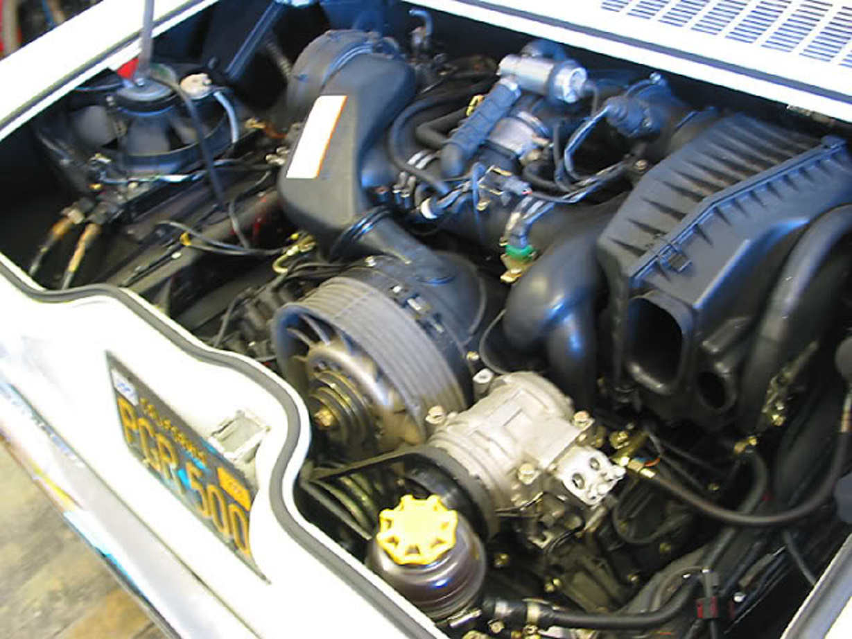

Im almost sure Im going to go Corvair 140 swap in a 914... Have done a bunch of searching on here and have to make some decisions. Big fan of Dr Evil, maybe he'll chime in. I like buses too...
Going Corvair wont be difficult for me, had a dozen of them in High School, my buddy I went to college with still considers a Corvair as a must have car (hmmm, Yenko Stinger or 911?) and I have to say it's been TOUGH looking thru all the Corvair Forums and not going on Craigslist to buy one to build a Yenko tribute... Going to restart my clothing business & double up on the Rogaine.
So I started to look into freshening the 2.0 I have but without the bus heads and a set of awesome Type4 heads ($$) - Type4 prices were scaring me, 6 cyl Porsche $ scares me. So the easiest cheapest way of HP without cutting up a good car is to go Corvair. I have one final Porsche 6 I'm running down so waiting...
But: If anyone has a line on any Corvair reverse rotation stuff, parts, complete engines I'd consider helping you get rid of it. Best case scenario is to find one already built up & just freshen it up - I'll be doing the Fuel Injection kit too. 140 heads, reverse cam & distributer gear. Spoken to Starr Cooke - neat guy but started to send me to the "best" money can buy right off. He's prob right though, I should build a really nice engine if I'm going to do it, I'm thinking a Corvair motor is many $ away from taxing the standard 914 gearbox.
