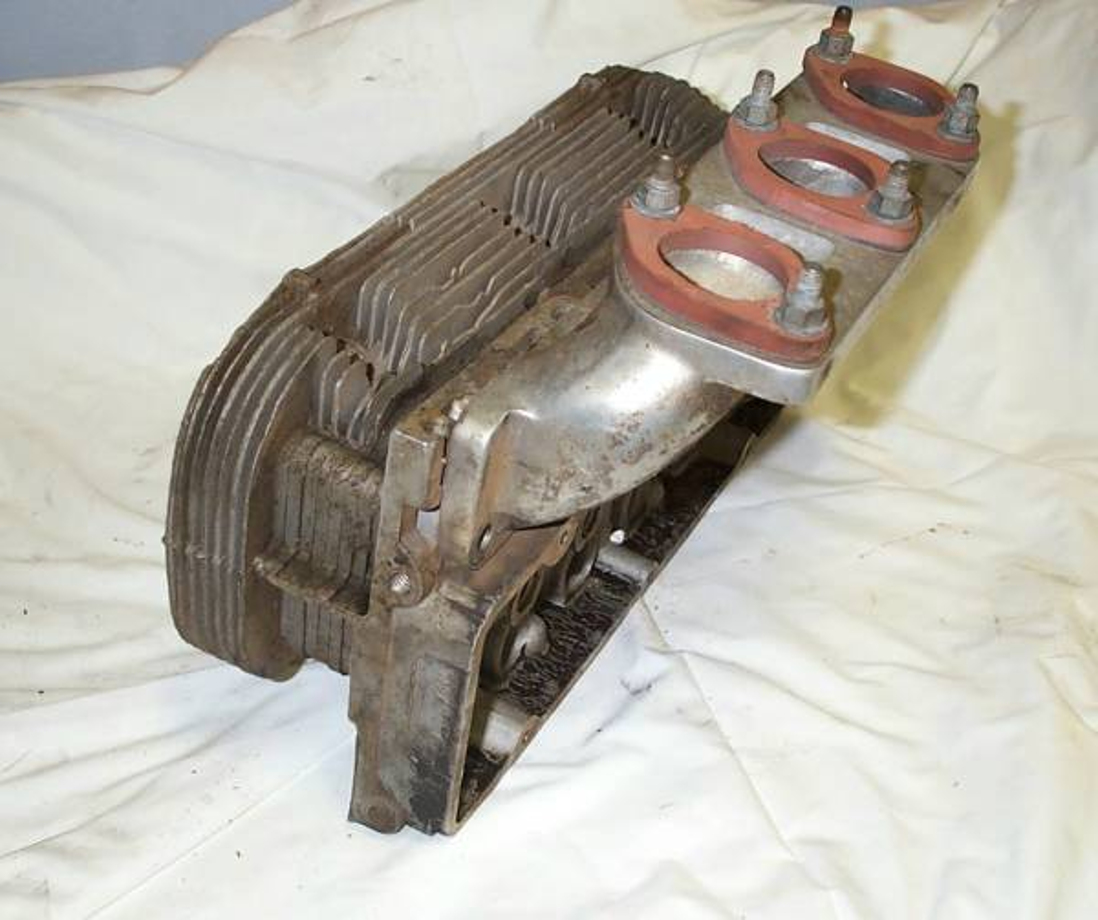

(Weber IDA3C) manifold,welded,for more power.
(IMG:style_emoticons/default/happy11.gif)
3.1L+
Things you might have to do,if you choose to do Corvair,is the undamaging of the boxer six from NY.
A 50/50 mix of acetone/auto-trans fluid(rustbuster).Frozen piston rings must be soaked Vertically,for a week.
http://www.loumash.com/GS/2010/weber.html
How many VW 94mm PnC's would you like sir?I'll take 12,thankyou.
