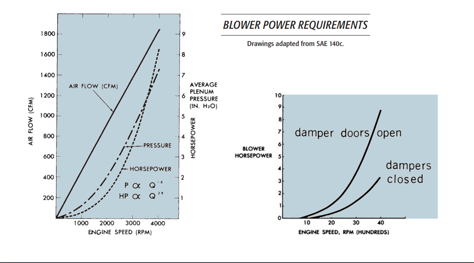

Cooling of the more performance Corvair boxer six is depicted graphically.(Corvair)
The addition of turbos of a 21st century vintage makes for larger intercoolers for both intake and heat dissipation.
Additional cooling fin area is described in the book,oil pump enhancement,mag-fan mods,and much more.

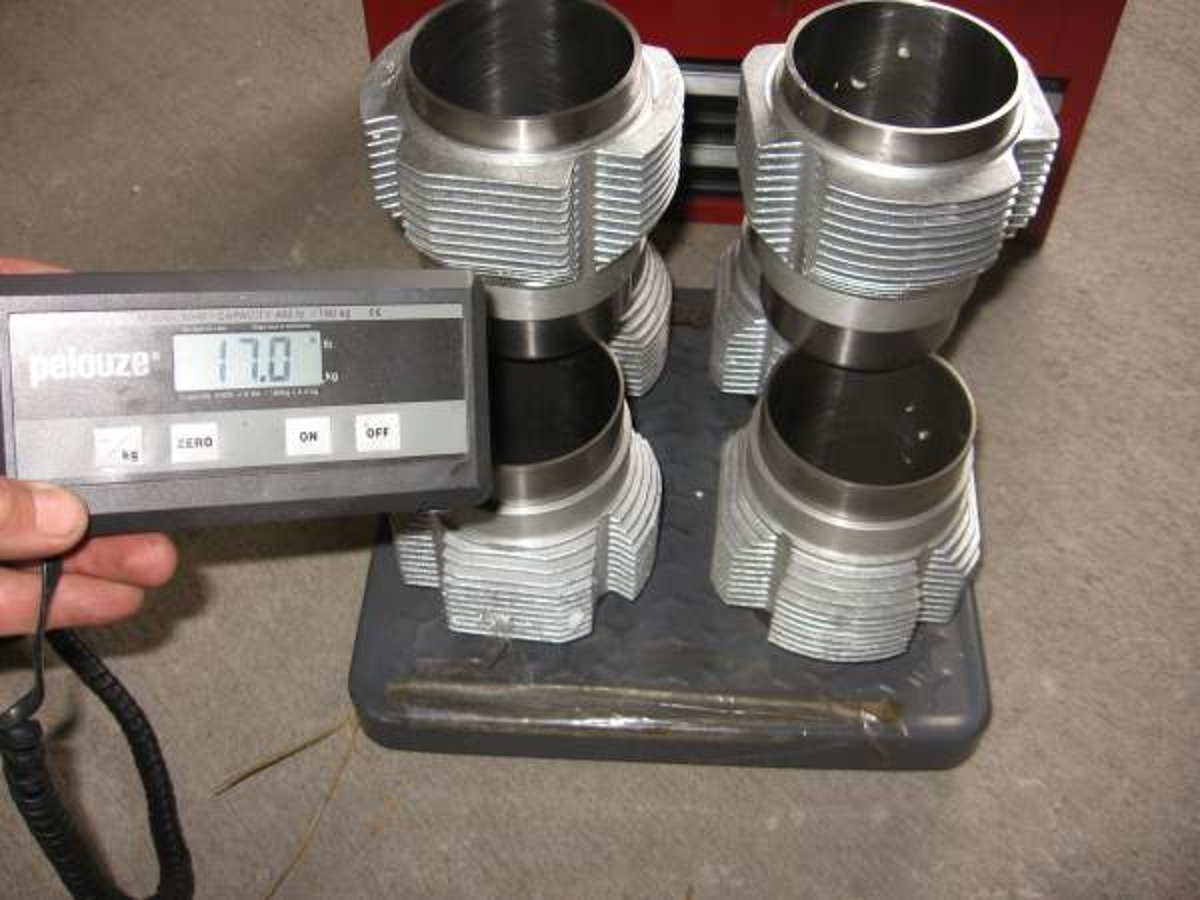

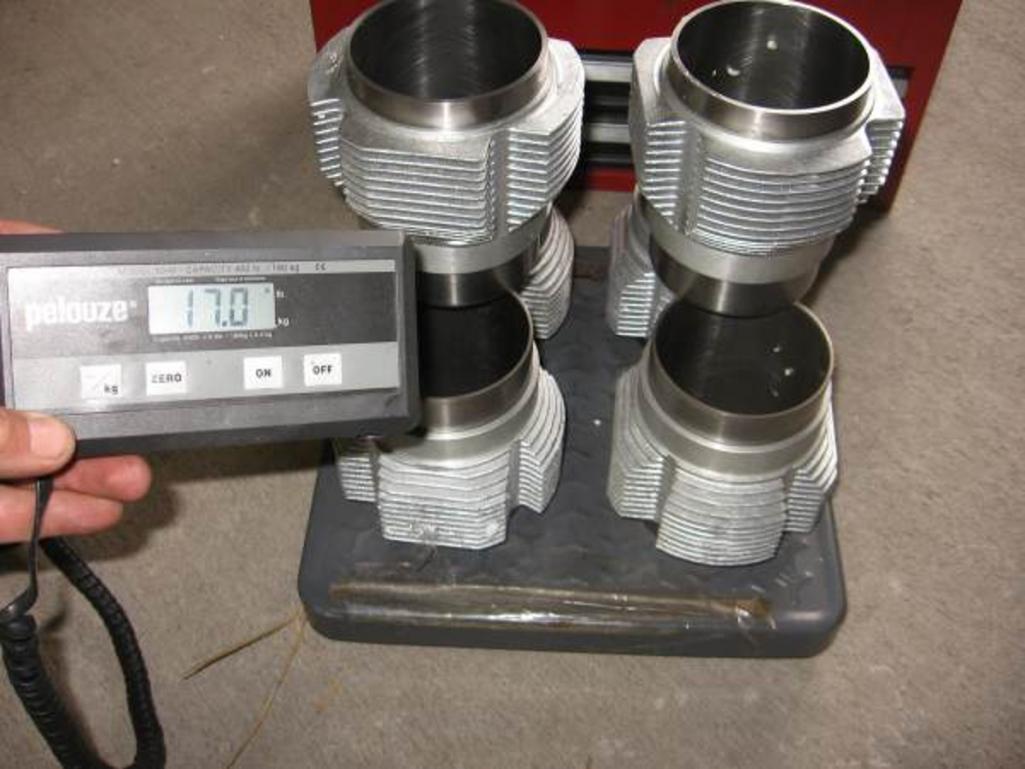

Nitron Inc's 88.3mm sleeved aluminum cylinders.
A fatbook builder desirous of a lighter Corvair boxer could include components from these vendors.
