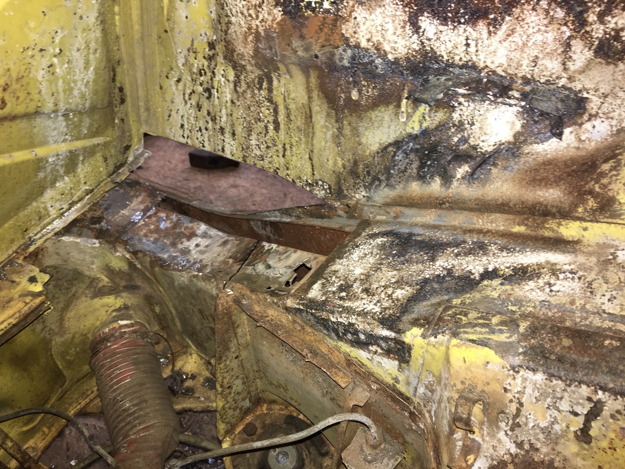

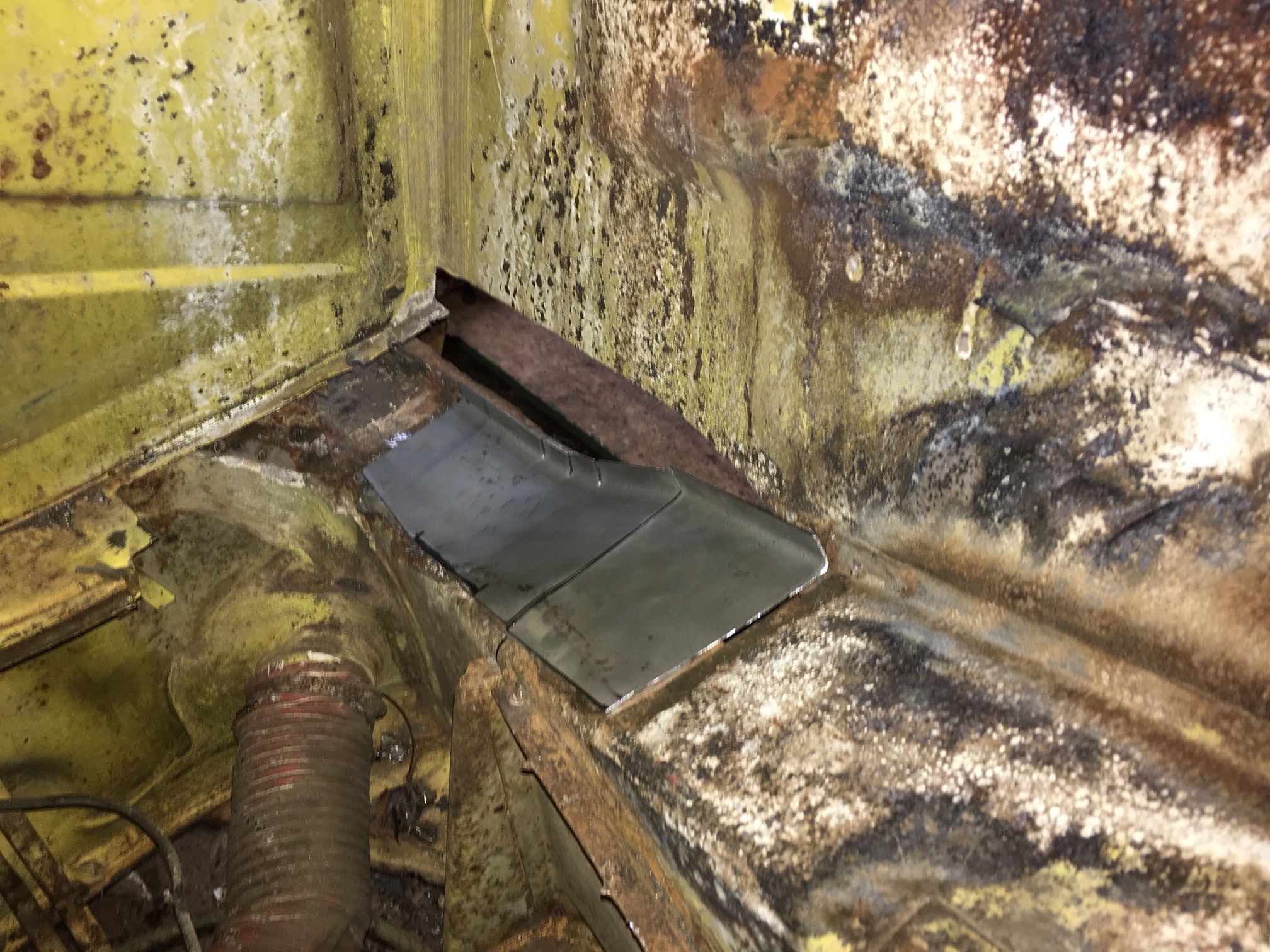

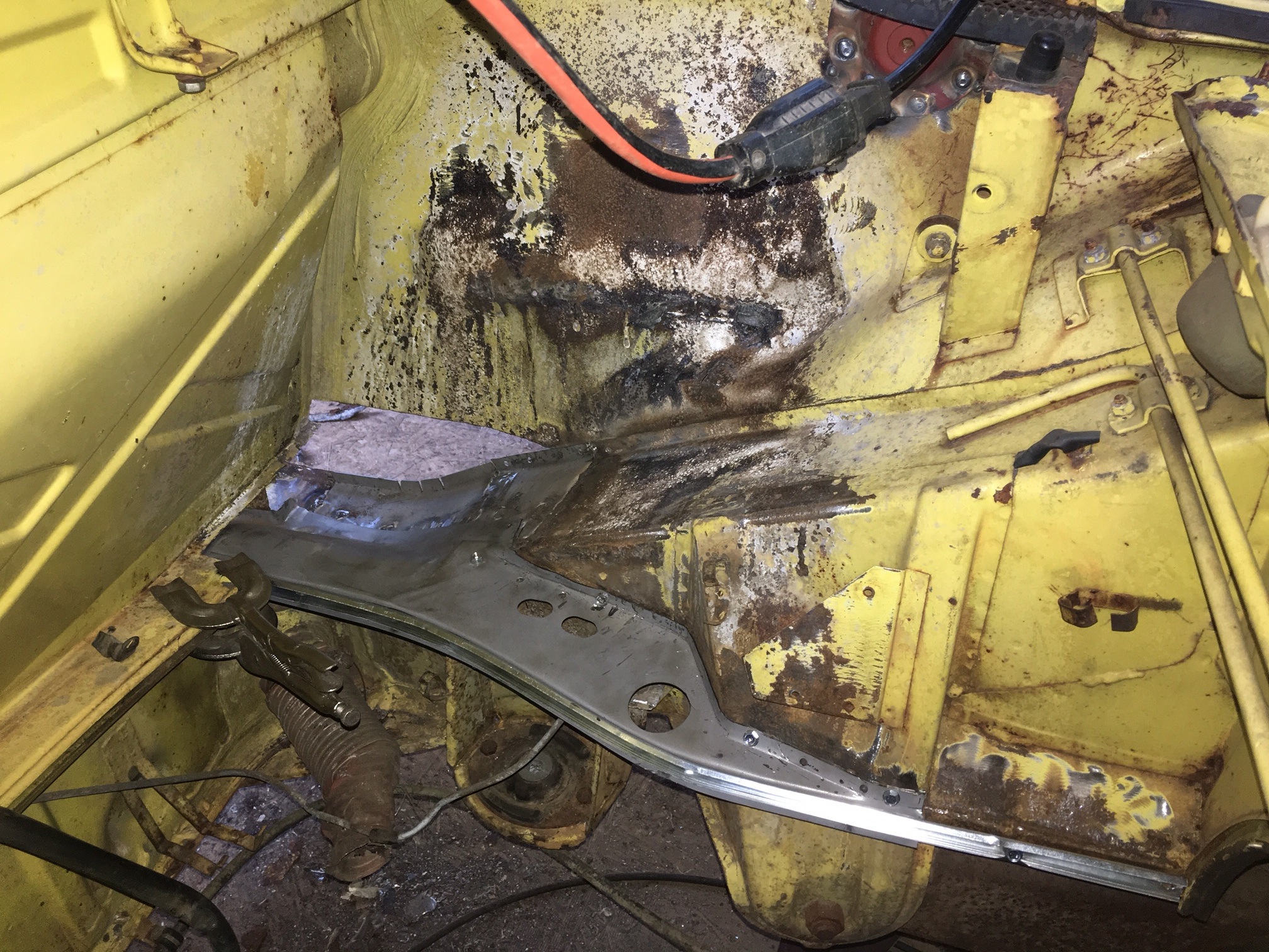

This weekend I made some big progress is the engine bay. I started by removing what was left of the "outer" layer on top of the long. I then made some patches, welded them in and mocked up the engine shelf. I made sure to keep the inner layer of the long intact for strength purposes.
Outer layer removed.
The patches.
Mocked up.
